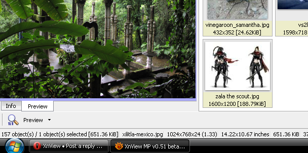

Re: Scroll doesn't work
Not, I found the problem:
That toolbar at the bottom is causing the problem (use "Restore layout A" to show it, it disappears after any configuration change). Deleting that toolbar or making it "float" solves the problem U_U
Yes, it's another toolbar... use this: and "restore layout A" to send that toolbar to the bottom (otherwise the bug won't show), then in viewer mode scroll downwards 'till the bottom... now the scroll doesn't work anymore.xnview wrote:If you have the toolbar at the bottom, you have the problem??
BTW, I'm using windows xp sp3, xnviewmp 0.51b and my screen resolution is 1280x800

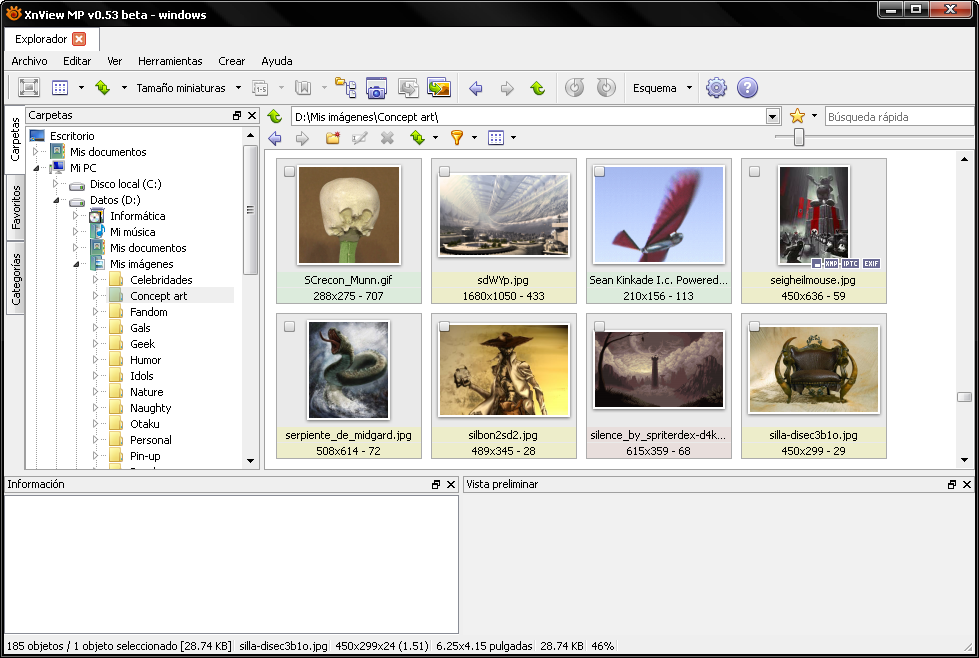

So I just find the problem here (this time for sure, I swearxnview wrote:I've tried and no problem(
It's a clean install of xnview-mp v0.53, the only thing I made was configure the thumbnails (margin, border, padding/spacing) to exactly fit the visible portion of the browser (there's no others partially-seen thumbnails). Thats all, go to the bottom of the screen and then you can't scroll upwards (or in fullscreen, using the floating "playbar" at the bottom and exiting with Esc)...
Also, this behavior cause some problem with this bugfix: Thumbnails refresh & 'create whole folder' not checked (http://newsgroup.xnview.com/viewtopic.php?f=62&t=26330, http://newsgroup.xnview.com/viewtopic.php?f=62&t=26209). The fix works, but not if thumbnails are configured like this... they refresh after any slight scroll (via mouse or the scrollbar)

Are you confirming the bug?baklazanek wrote:Doesnt work for me
Still present in win 0.56: Options»Thumbnails»Appearance»Padding=10 | Increase browser view-port to show complete thumbnails only | tada!
