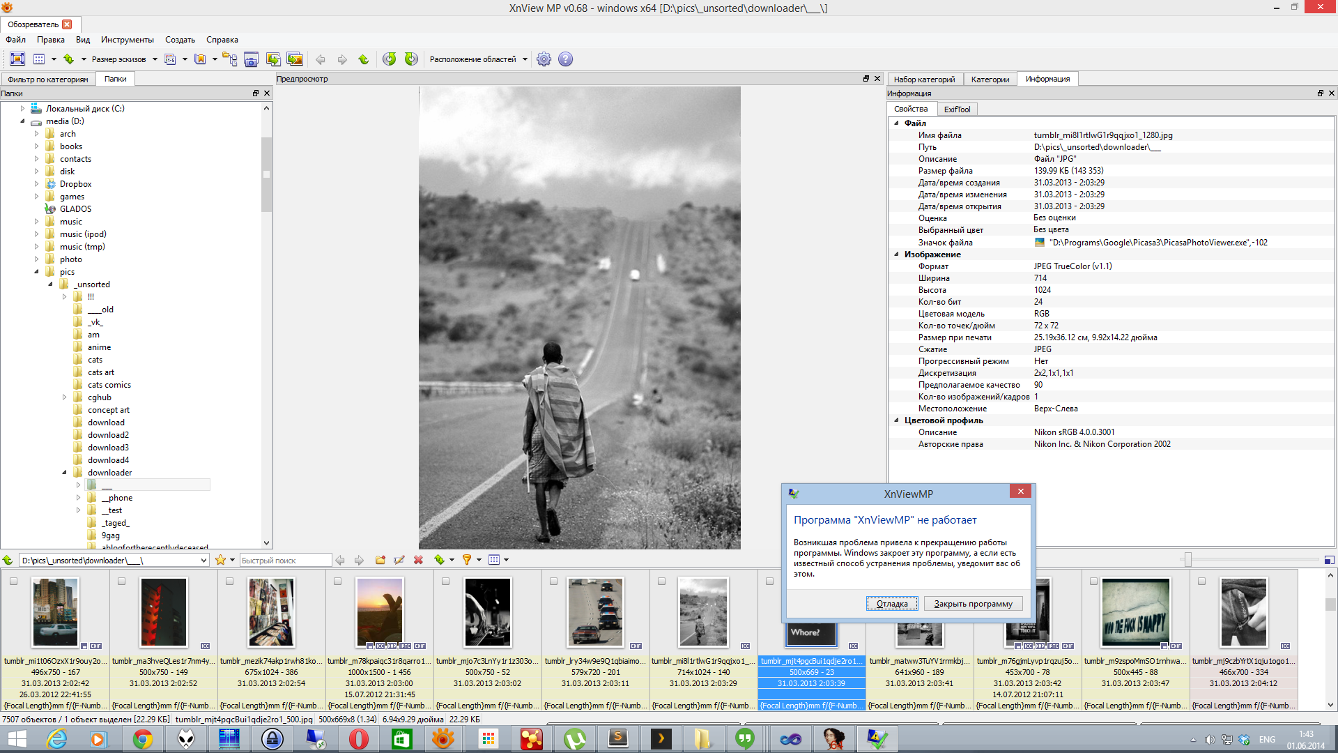

XnViewMP 0.68 x64 crashes when i'm browsing images. Usually it happens on the same pictures. I can run program again, watch pictures from begining and the program will crash exactly on the same image, but when I try to copy this 'problem' image to another directory there was no problem of viewing it. Also when I run the second instance of XnViewMP this problem can be occured on the another picture. So I believe that problem not in the images.
I tried to watch in VS Debugger and in IDA why it can happens and found that It happens in function with this QT api:
QImage::scaled
QImage::~QImage
Somewhere while program tried to free heap and at this moment I see an exception: c0000374 (heap corruption).
I don't realy know what this function is for and what realy happens here, but I hope this information could be helpful for you.

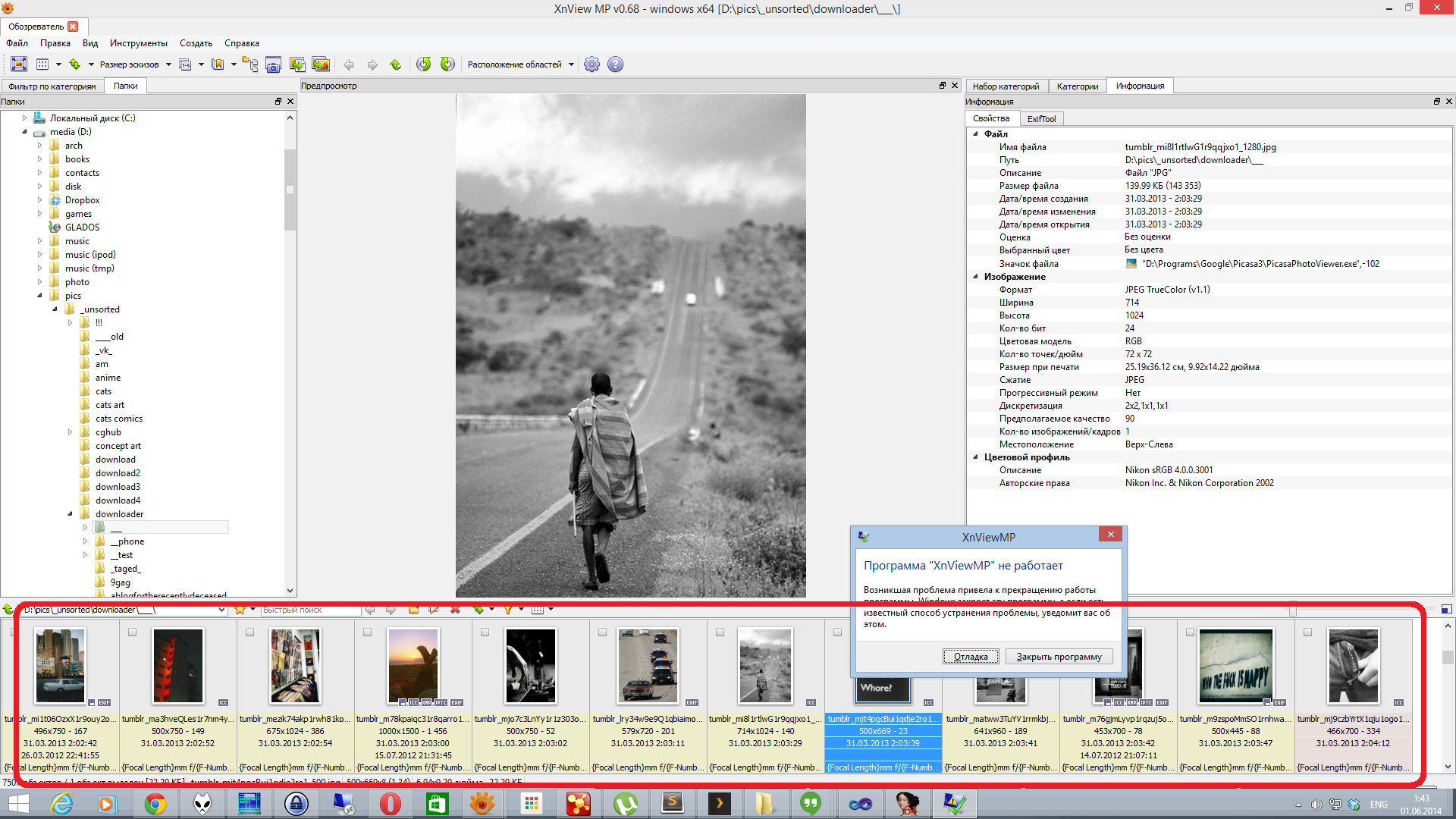

when I remove
[Browser]
state=...
Everything works fine, but I don't like default browser configuration.
yuzvir
Posts: 6
Joined: Sat Feb 08, 2014 5:50 pm
Re: XnViewMP 0.68 Crashes on Windows 8
Post by yuzvir »
I also found that problem appears only when thumbnail panel on the bottom.
