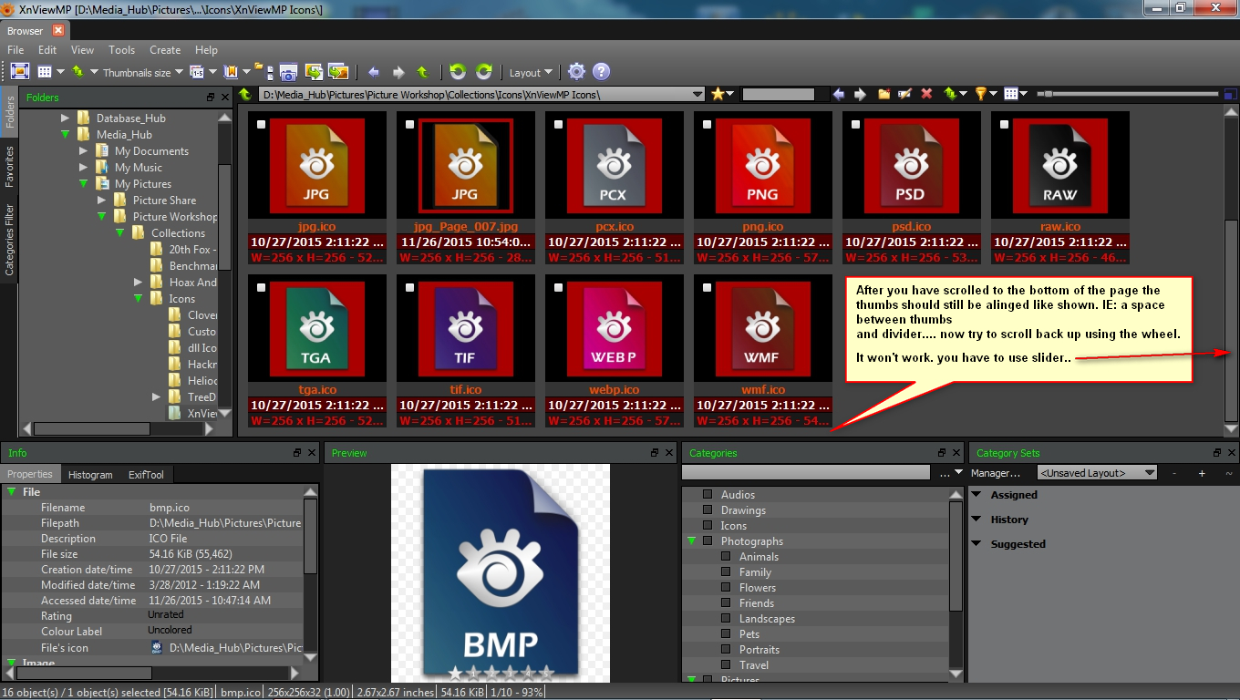

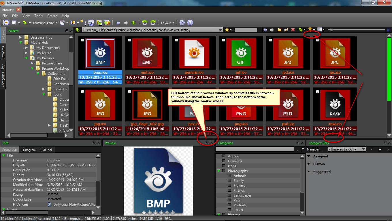

So i figured I would post a way to reproduce this 100% of the time with screen shots.
The browser window can be placed anywhere and still get same results. You just have to have top and bottom algned like shown.
Here:
[Edit:] The pictures loaded out of order. See bottom Image 1st...
Scroll Bug Step 2.
Scroll Bug Step 2.
Scroll Bug Step 1.
Scroll Bug Step 1.
