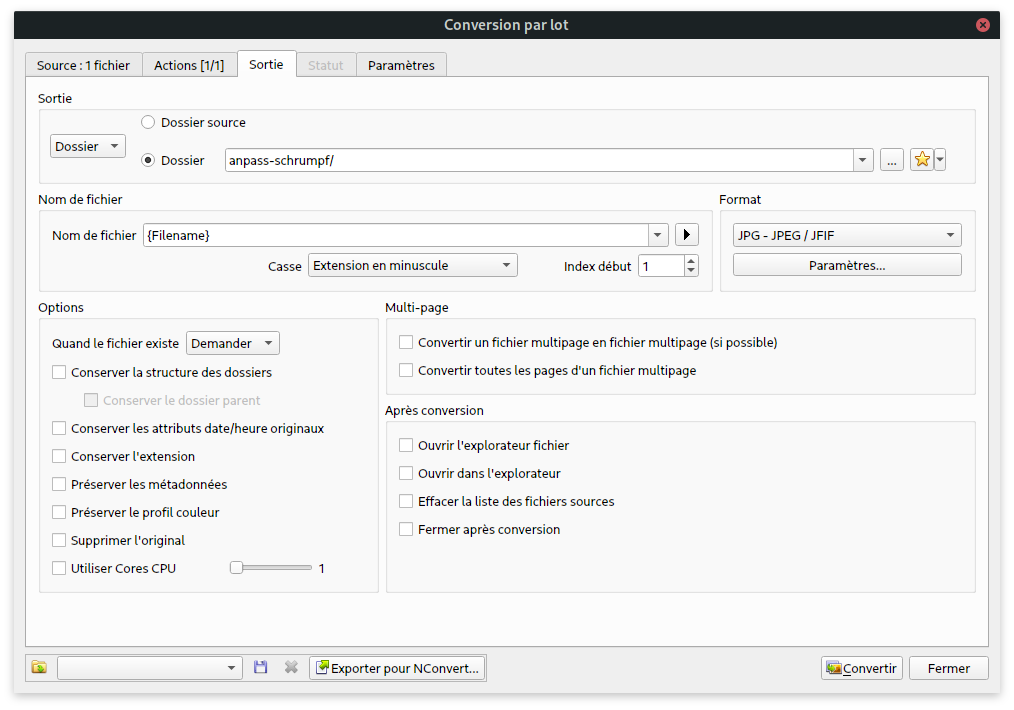

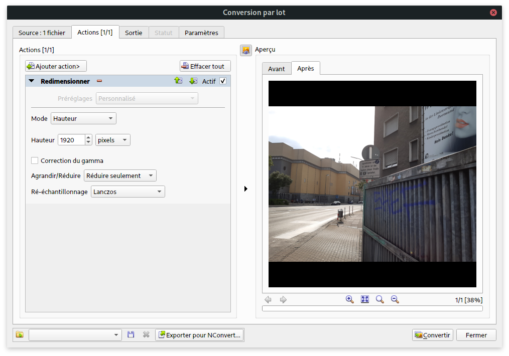

Konzertheld wrote: Fri Apr 10, 2020 8:39 am Not fixed in 0.96.
i can't reproduce, could you send me screenshots of 'Actions' & 'Output' tab?
Konzertheld
Posts: 52
Joined: Sun Feb 27, 2011 9:43 pm
Re: "Change size" by height sometimes ignores height setting
Post by Konzertheld »
Sure.

And sure, it happens for all my images. Here is a screenshot I just made that has a height of 1080px and when I try to convert it to a height of 1000px it instad gets converted to 800px height.
