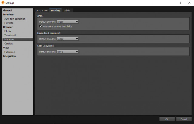

Bonjour Pierre,
Do you have tried to change settings>Metadata>Encoding?
I didn't change anything there (I hadn't even noticed it existed). Looks like this currently:

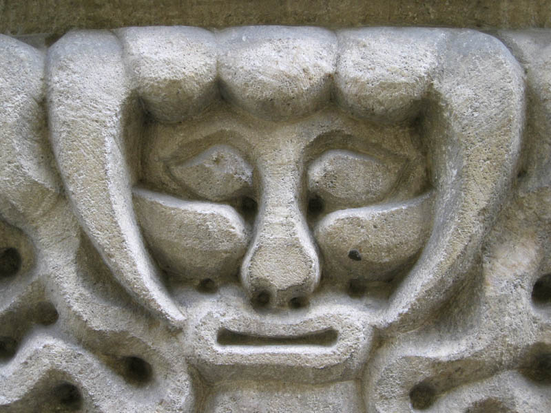

Here's a photo with "Uzès" as a keyword:
Let me know if I need to send it to you in some other way.

il faut choisir 'utf8'

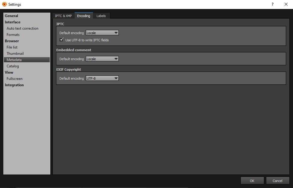

So for those who may come to this post in the future, Pierre is saying to choose 'UTF-8' from the dropdown menu at Tools/Settings.../Metadata/Encoding/IPTC.
Looks like this:
This did indeed resolve the problem I described above.
