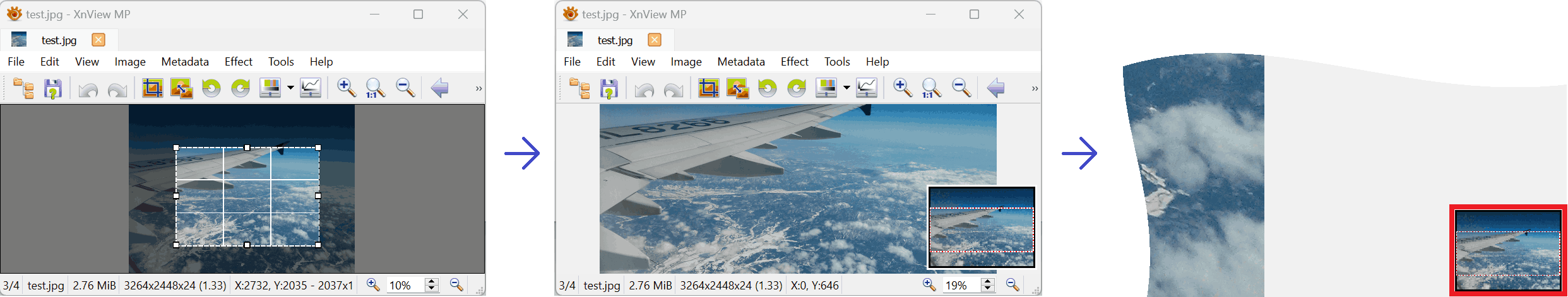

2. open large image (>display resolution) in viewer
'Fit image to window, large only' is the default option
issue A
3. press middle button to switch into fullscreen mode
- make a selection
4. click middle button inside of this selection
app will zoom to the selection

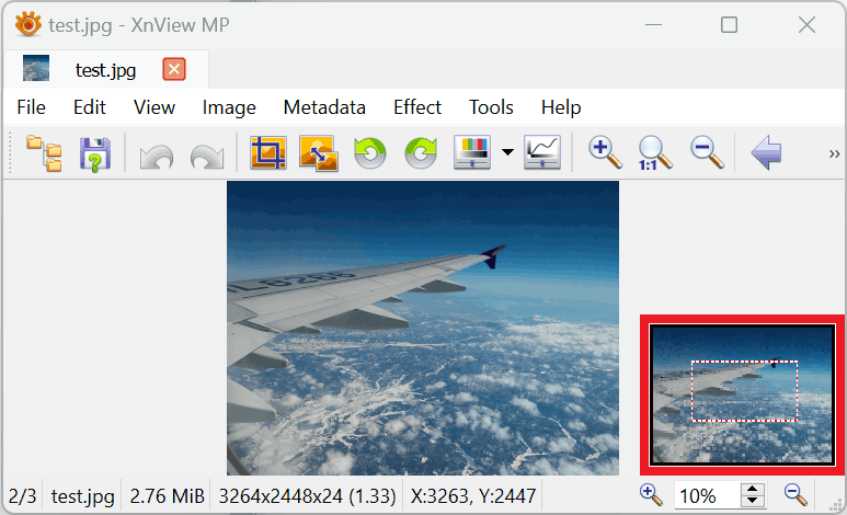

5. click middle button again
app will switch to normal mode (image is fit to window)
navigator still remains on screen
expected behavior
navigator should not be visible since image is fit to window
issue B1
3. make selection
5. click middle button on image
app will switch to fullscreen mode (image is fit to window)
expected behavior
issue B2
continue from B1
6. click middle button
'Auto image size' will reset to 'No fit'
expected behavior
'Auto image size' should retain current option - 'Fit image to window, large only'
