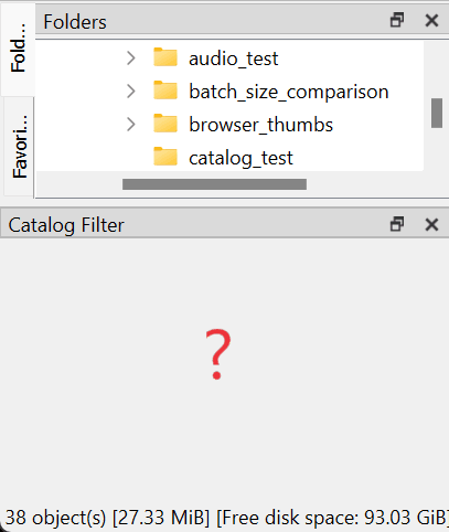

XnViewMP 1.6.5 64bit
Browser - catalog filter - blank filter
0. unzipped version, Catalog is enabled
1. move 'Catalog filter' pane under 'Folders' pane
2. .. not sure about exact actions :D but it reproduces with this .ini
xnview.zip
Catalog filter becomes empty
If 'Catalog Filter' panel is moved anywhere, its contents will appear

if I move "Catalog filter" pane (eg reposition/undock) - UI refreshes and shows all filters.
The issue is - there are some unknown circumstances that lead to this bug

I'm randomly seeing this issue too:
viewtopic.php?t=48790
I can fix it by dragging the horizontal separator/divider down and up again but it comes back again on random relaunches. Not sure of exact cause but has been happening for months for me.
