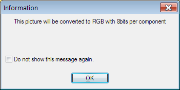

The input TIFF is CMYK and XnView can only open it as an RGB image:
Could someone advise on the optimum settings to use in the XnConvert 'Actions' tab to maintain the original colours?
