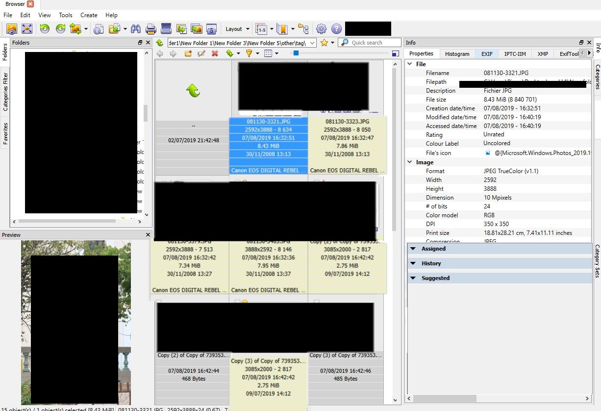

Posts: 48591
Re: A couple of questions about MP
something like that?

xnview wrote: Thu Sep 05, 2019 1:33 pm something like that? 001.jpg
Thanks for the answer.
Yes, but with one change:
On this layout all the Categories and Category Sets would always be accessible, so it would be ideal for this kind of work. The Creation of new Category Sets could happen in the bottom right window (for example by a right click context menu) and adding words to Sets could be simply drag'n'dropping them from the upper Category window. Deleting a Category Set could be done by right clicking on the set name and choose a Delete option from a context menu.
I would be happy with your version too, it is also good.
Thanks,
Tango
