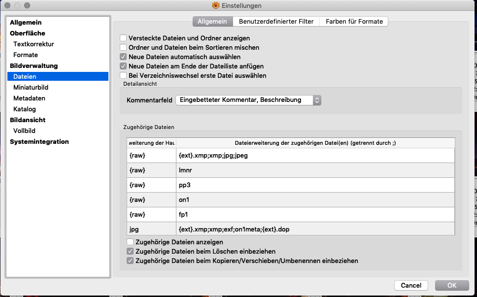

Sorry for my late reply...
- Posts: 48626
Re: Problem when Moving RAW Files...
how do you move the file? Drag&drop, move to?
ruebyi
- Posts: 48
- Joined: Thu Nov 22, 2018 9:28 pm
"Move to"
- Posts: 48626
the file that you move is a JPG, and is based on full filename, so you need to add on the jpg line
{ext}.dop-

- Posts: 48626
what do you have now in this setting?ruebyi wrote: Sun Apr 07, 2019 9:18 am Thank you - but now I realise, that the jpgs to my raw files are not moved...
Sorry I don't get it...

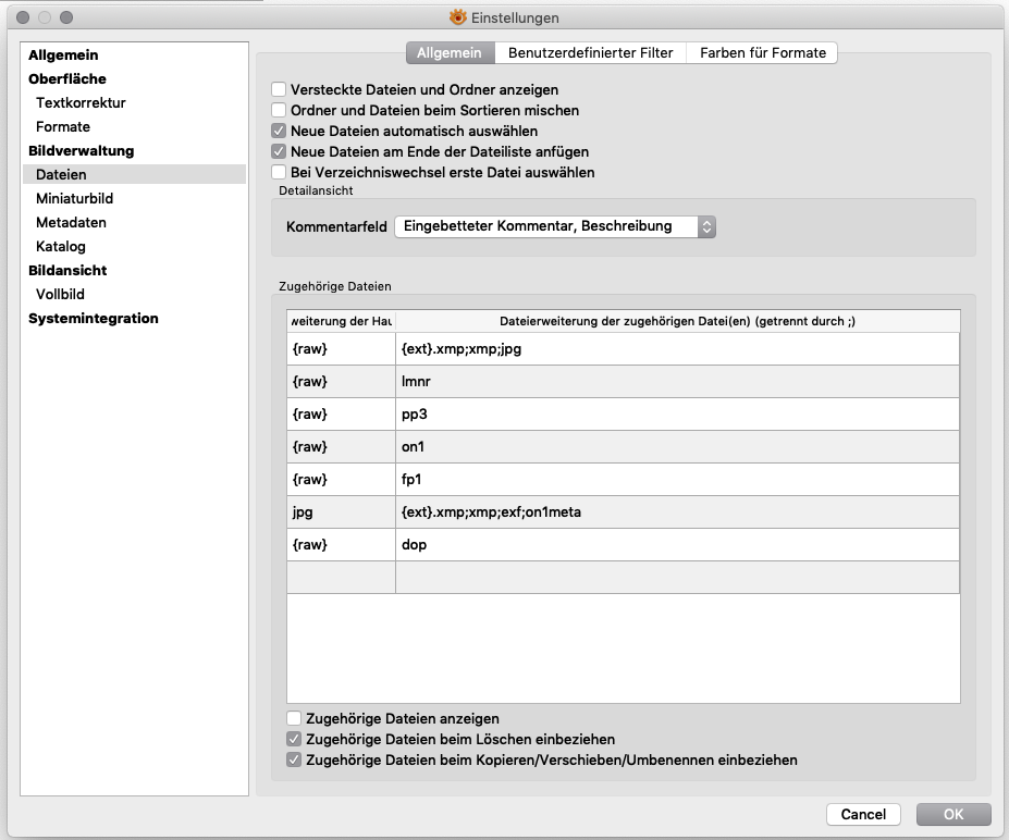

ruebyi
- Posts: 48
I attached the screenshot!
Thanks for your help!
- Posts: 48626
so you need to {ext}.dop to {raw} if you move the raw, and you want to move jpg & .dop files
