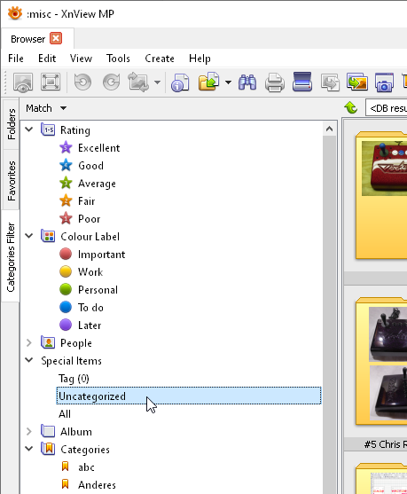

Thank you for your request, artsi. In "Category Filter" tab there's a node "Special items > Uncategorized". When choosing this node all non-categorized files will be displayed. Please note that it may take a while till all the non-categorized files are displayed.

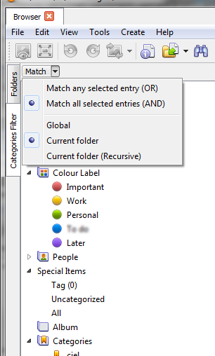

When using categories filter, set your choices in "Match" menu at the top of this pane. (Current folder ? , recursive or not ...)

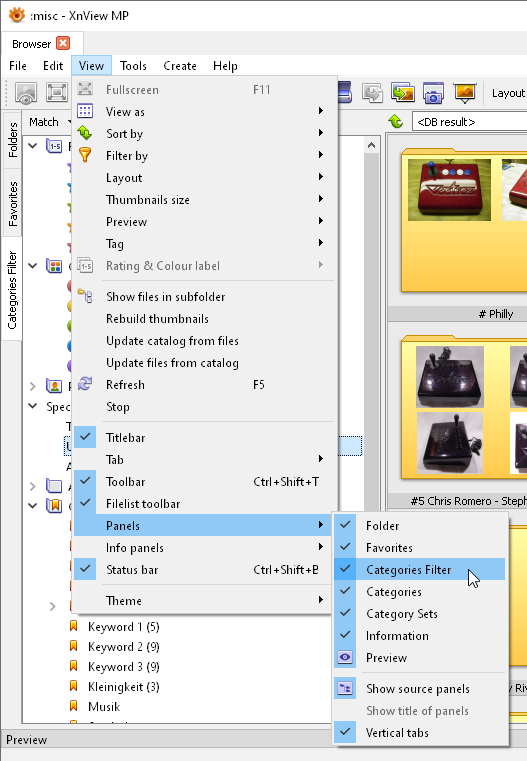

Here's where you can find the special category "Uncategorized" that I've described above: By default, "Category filter" tab is visible and perhaps you've hidden it by accident. If so, you can unhide it here: Please note that you can refine your search using "Match". E.g. you can search in local folder only or global. But currenctly there is no way to search all images which are NOT assigned to a specific category. Only thing that you can do is search for images that aren't assigned to any category - see above.

I don't know any shortcut to select all categories in search drop down menu ...michel038 wrote: Tue Sep 27, 2022 10:03 am When using categories filter, set your choices in "Match" menu at the top of this pane. (Current folder ? , recursive or not ...)

Thanks for pointing it. I never saw that. I'm sure I would have seen it before I got married (I'm quite well trainedmichel038 wrote: Thu Sep 29, 2022 4:16 pmmatch15.pngmichel038 wrote: Tue Sep 27, 2022 10:03 am When using categories filter, set your choices in "Match" menu at the top of this pane. (Current folder ? , recursive or not ...)
