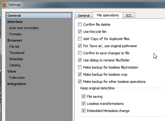

When you are in browser mode (thumbnails) and you click the rotate button, the image is rotated and saved automatically.
When you go into view mode and use the rotate button, and then advance to the next image, it does not auto-save. But I want it to auto-save and not ask me. Right now I have to remember to save it every time.
Am I missing a setting somewhere?
Here is a screenshot of my current settings (version 0.87)

Well, I'm sort of back to this again, and I'm re-using my own thread - since I think it probably has to do with the original problem of it not saving when I change view modes.
Here's my workflow.
(Tabs are showing)
I'm in Browser mode, and find an image I want to work with, so I double-click it (according to my settings) to open it in view mode.
Now I push the *Automatic Levels* button to adjust the colours.
Now I push the arrow button to go to the next image.
XMP asks me if I want to save.
However, this should be automatic. I don't want to always confirm the change because I *always* want it to save.
Maybe there should be a checkbox in Settings > General > File Operations that can go below "Confirm File delete" and could be "Confirm File Save".
Posts: 47107
Re: Auto-save after Edit in View Mode
ok, i'll add a setting or pehaps a checkbox 'don't ask again' when saving a picture file
