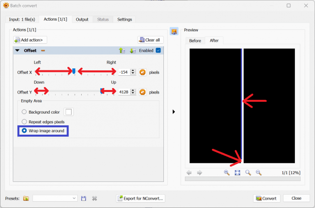

Issue A
5. set offsets above image's dimentions (100x4000 in our case)
you will succeed, resulting in white lines in Preview
Issue B result from issue A

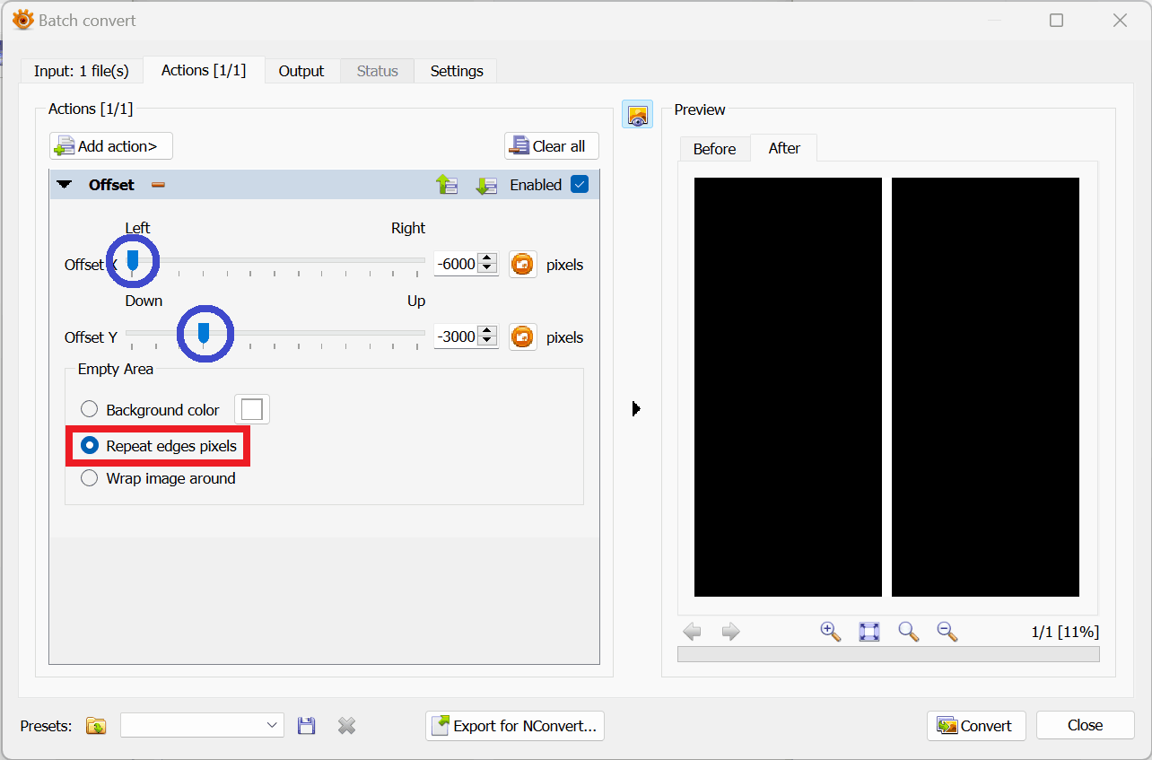

5. set offsets:
- X somewhere below -6000
- Y somewhere bove -3000
6. select 'Repeat edge pixels'
app will crash

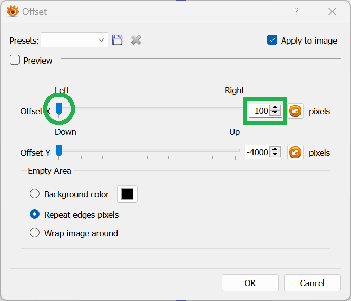

Issue C
5. try to modify value via textbox controls:
- press ⏶- value will decrease. It shall increse.
- press ⏷- value will increse. It shall decrease.
The attachment C.png is no longer available
Issue D
Background color control has different default color in Batch convert (white) and Viewer Offset (black).
Guess it is better to have similar color in both cases.
ps. Viewer's Offset does not have these issues, it also uses correct X scale based on image dimention.

Posts: 47027
Re: 1.4.3 - batch convert - Offset incorrect scale and controls
