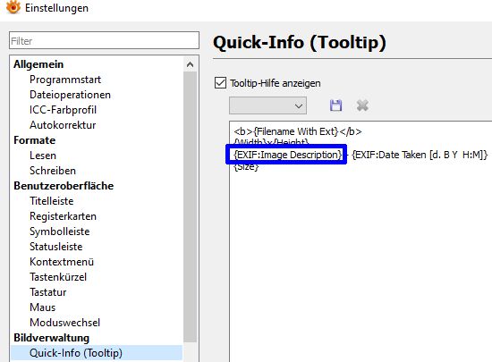

I tried it using the new Version 1.9.9
The Coding setings were changed from "UTF-8" to "ISO 8859-1"
It can be reproduced using the "Test-Image.jpg" from the attachment at the beginnig of this issue.
Right click the image and save the image locally.
In the Setting, use this for QuickInfo / Tooltip
<b>{Filename With Ext}</b>
{Width}x{Height}
{EXIF:Image Description} - {EXIF:Date Taken [d. B Y H:M]}
{Size}
The result still shows the wrong decoded Exif description in the tooltip.
