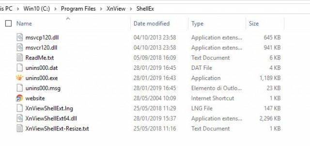

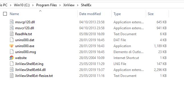

i'm think i'm wrong somethink in the installation, beacuse i tried again the installation on other 2 pc where never was installed xn software , i install only xnshell but there is the same problem... the register.bat procedure is required?
in attachment the screenshot of my installation folder
Posts: 46948
Re: XnView Shell Extension
emmequ wrote: Mon Jan 28, 2019 4:03 pm i'm think i'm wrong somethink in the installation, beacuse i tried again the installation on other 2 pc where never was installed xn software , i install only xnshell but there is the same problem... the register.bat procedure is required?
Please use the setup

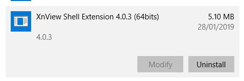

could you try the new version?
emmequ
Posts: 12
Joined: Sun Jan 13, 2019 10:00 pm
Post by emmequ »
xnview wrote: Tue Jan 29, 2019 4:15 pm could you try the new version?
yes, last time i already tried new version ;)
