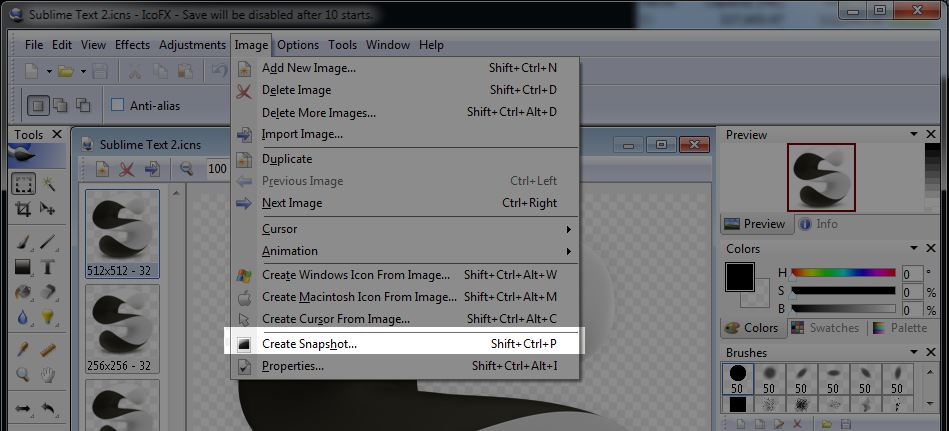

Update: Support for ICNS and RSRC icons has since been added (a while back) to the 'Icon Snapshot' of XnView MP, thank you Pierrebudz45 wrote:Pierre,
I just noticed that 'Icon Snapshot' feature does not support Apple's Icon files (.icns)
Furthermore, just for the interest of this topic,
IcoFX has an Icon Snapshot feature to. So XnView MP, Axialis IconWorkshop and IcoFX all have an 'icon snapshot' feature
