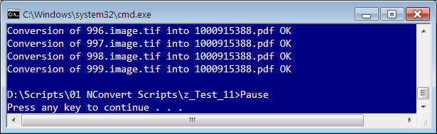

Yes, but using a wildcard as in the following code:
nconvert.exe -out pdf -multi -overwrite -c 1 -o 1000915388.pdf *.tif
The 1000-page PDF output created is attached, but I should point out that the test TIFFs are all identical, and as they consist of just a small white canvas, the PDF pages all, correctly, appear as blanks white pages.
Is there a reason why you can't simply use a wildcard as above, as it seems the easiest way and automatically accepts any number of input files?
I should also point out that the 1000 test TIFFs (which I originally created to test renumbering operations) all have very short file names, so the command line character limit is unlikely to be reached.

This is getting slightly confusing, you first say that after lengthening my test images filenames you have reproduced the original problem, which seems to simply confirm that the length of the command line is the problem, then in your edit you say that all files were processed??
I've repeated my batch file test using the same code but using your test images with the extended filenames and, as expected, it runs successfully again... It also correctly produces a 1000-page PDF file.
Is there any reason why you can't use a wildcard term *.tif ?

Please, look at file 543 conversion
the pdf generated has 999 pages
Probably you miss my previous response :)
Posts: 4617
Re: Char removed from File name in long list
RobertoG wrote:Please, look at file 543 conversion
If you have, in fact, discovered a limitation or bug in NConvert or elsewhere I can't usefully comment on that...
The fact that one input file hasn't been converted explains the 999-page rather than 1000-page PDF output file created.
cday wrote:Is there any reason why you can't use a wildcard term *.tif ?
RobertoG wrote:Probably you miss my previous response :)
RobertoG wrote:i use explicit list because is not guaranteed that all parts needed to be merged
I saw that in your first post and didn't really understand it...
If you could explain in more detail, there may be another way to approach the problem that might work directly, without the need to create the output PDF in stages... :?:

To confirm that this way is not appliable here, i tested with:
nconvert.exe -out pdf -multi -overwrite -c 1 -o 1001011879.pdf  1001011879_P*
getting
** NCONVERT v6.82 (c) 1991-2016 Pierre-E Gougelet (Jan  4 2016/21:36:59) **
        Version for Windows Xp/Vista/7 x64  (All rights reserved)
** This is freeware software (for non-commercial use)
Conversion of 1001011879_P1.tif into 1001011879.pdf OK
Conversion of 1001011879_P10.tif into 1001011879.pdf OK
Conversion of 1001011879_P11.tif into 1001011879.pdf OK
Conversion of 1001011879_P12.tif into 1001011879.pdf OK
Conversion of 1001011879_P13.tif into 1001011879.pdf OK
Conversion of 1001011879_P14.tif into 1001011879.pdf OK
Conversion of 1001011879_P15.tif into 1001011879.pdf OK
Conversion of 1001011879_P16.tif into 1001011879.pdf OK
Conversion of 1001011879_P17.tif into 1001011879.pdf OK
Conversion of 1001011879_P2.tif into 1001011879.pdf OK
Conversion of 1001011879_P3.tif into 1001011879.pdf OK
Conversion of 1001011879_P4.tif into 1001011879.pdf OK
Conversion of 1001011879_P5.tif into 1001011879.pdf OK
Conversion of 1001011879_P6.tif into 1001011879.pdf OK
Conversion of 1001011879_P7.tif into 1001011879.pdf OK
Conversion of 1001011879_P8.tif into 1001011879.pdf OK
Conversion of 1001011879_P9.tif into 1001011879.pdf OK
...in the wrong order...
I can't find any way to sort in the "correct" order, and i can't rename original files
