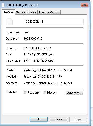

Re: Go folders and subfolder recursively and convert
file information

I don't immediately understand why no file extension is shown, as you've said before, yet the filesize is known.

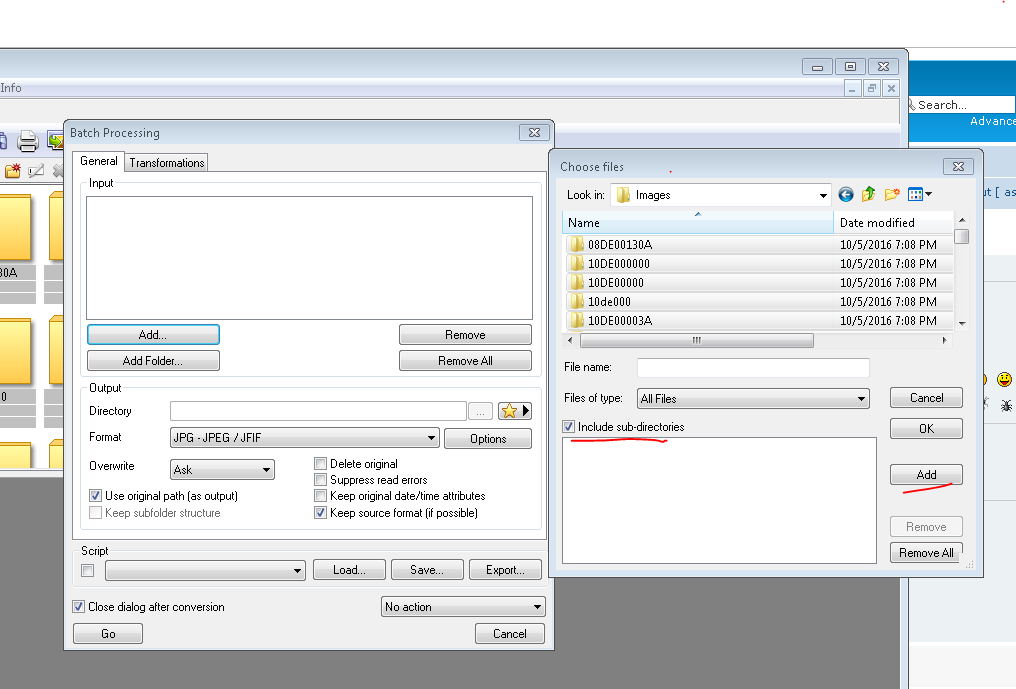

i want to convert using XN View keep as it is on original format (not .jpg or Tiff or anything else)
if you open the file in Windows photo viewer get error but if you convert (keep original format) using (XnConvert Version 1.55 - windows (Mar 4 2013) - Libformat version 6.33)i you will be able to open.
see picture KEEP ORIGINAL FORMAT

So, is your question simply how to obtain recursive processing of your files using XnConvert (rather than XnView Classic, for example, in the screenshot you posted today)? My quick test yesterday suggested that if on the Input tab you add the parent folder for your files, all the images in the lower level folders will be loaded and processed automatically, so could you try again with XnConvert 1.73 and see if you can figure out how to obtain that result...
The settings you've posted above would normally only result in the existing files being overwritten with similar files, but doing a quick test on your sample file with those settings and no actions set, it is converted to a [slightly larger] TIFF file with an extension. [And interestingly, the resulting TIFF file can be viewed in XnView software, but not in the 'other' program that identified and could view the sample file you posted...]
