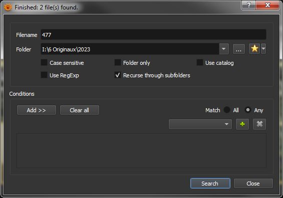

michel038 wrote: Fri Dec 15, 2023 3:54 pm
If the "Folders only" box is not ticked, the search will no longer find the files. :(
For me it does find files matching the search string and all files when there is no search string specified when Folders Only is not checked.

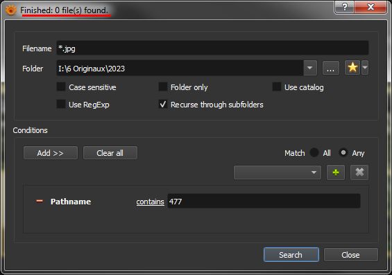

Posts: 1585
Re: Folder name search
Post by michel038 »
O files found :(
even if "Use catalog" is checked
even if *.JPG or *.* is set as a filename

michel038 wrote: Fri Dec 15, 2023 4:09 pm O files found :(
Perhaps additional condition Pathname contains "477" is causing a problem?
Posts: 1585
Post by michel038 »
... is working.

I didn't understand the use of the "Filename" field.
I should have read my own documentation ... :mrgreen:
Here we can type a part of a filename, or of a foldername if "Folder only" is ticked.
A tooltip would be appreciated ( "Enter part of a filename or foldername and check options" )
If "Use catalog" is ticked, empty folders won't be shown (and search is always case sensitive. :bug: )
If it's not, all subfolders are browsed (if "Recurse" is ticked), the result is instantaneous as well, and "Case sensitive" option is respected.
Very efficient, thank you Pierre !
So it seems that the "pathname" I used in the search in the previous first post is perhaps useless...

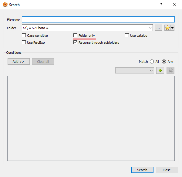

A slight suggestion, perhaps many people do not need to display folders when they are searching for images. Right now by default folders are also returned in search results e.g. if search with no criteria there is no modifier to turn off folders in search results.
Only search modifier related to folders is "Folders Only" that actually turns off individual images in search results.
Perhaps would be more practical and habitual to most people to have the old search results that return images only and replace "Folders Only" with "Include folders" - that will include folders in search results.
However for the case when someone needs to search for folder only without images there will be no option.
So perhaps drop down menu or radio button with options "Folders Only" and "Include Folders" is preferred.
Even better three options to specify what results to return "Files Only", "Files & Folders", "Folders Only" would be of upmost flexibility.
