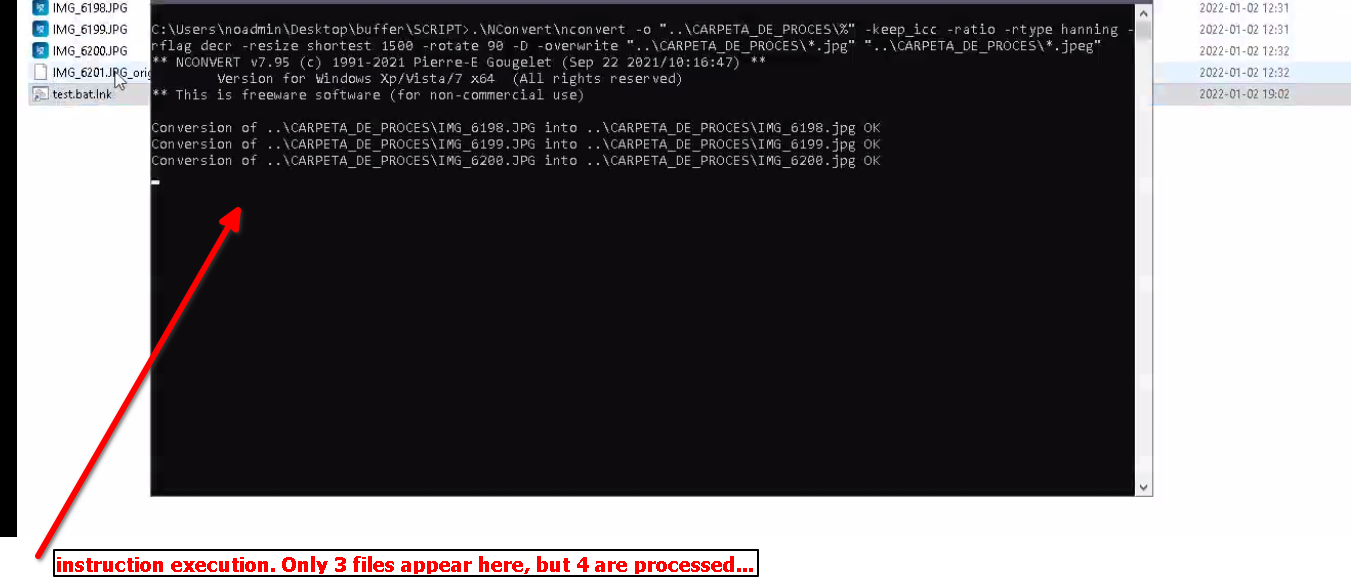

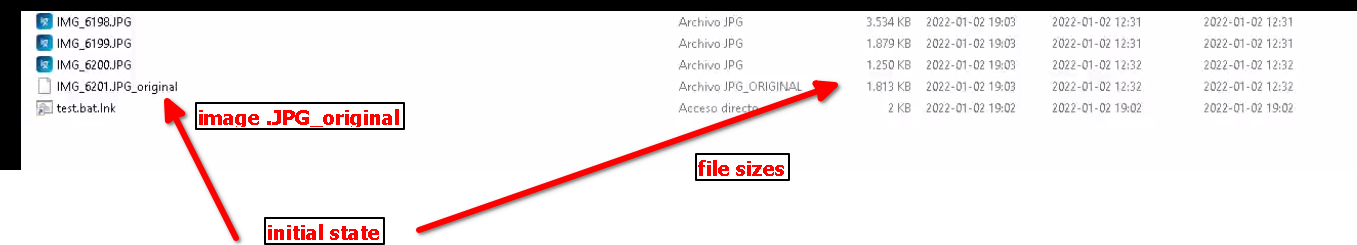

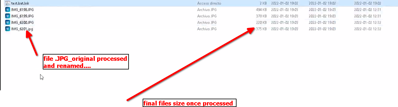

I think these 3 images synthesize what is happening:

Much easier to follow, thanks, I opened the three attachments in adjacent browser tabs...
I still can't see an explanation, though, but I can make some suggestions that (again) probably won't be helpful:
o You have both -D and -overwrite and I'm not sure of the logic of that, although it probably is of no significance in practice.
o The -o term still doesn't include an extension, although you previously said that including one didn't resolve the issue.
o What if you remove the alternative ....*.jpeg input term?
o Presumably IMG_6201.JPG_original doesn't open in XnView MP (or 'Classic)?
o You have NConvert v7.95 installed, the help file of my recently downloaded versions shows v7.98, which is unlikely to be significant, but for want of an immediate way forward you might try testing with a slightly earlier version just in case of a recent regression in the code.
o In general in a case like this where there is no obvious way forward, it can be useful to simplify the tested code to the minimum required to illustrate the issue, sometimes in doing that the reason becomes apparent. Alternatively, if possible try approaching the problem in a different way.

- Posts: 48738
Re: file extension error?
the problem is the way that windows expands wildchar, if you use .jpg_orignal is listed

tomv wrote: Thu Dec 09, 2021 8:01 pm I have a folder with these 2 files: IMG_4954.JPG and IMG_4954.JPG_original.
Then exec this command:
.\NConvert\nconvert -o "..\CARPETA_DE_PROCES\%%" -keep_icc -ratio -rtype hanning -rflag decr -resize shortest 1500 -rotate 90 -D -overwrite "..\CARPETA_DE_PROCES\*.jpg " "..\CARPETA_DE_PROCES\*.jpeg "
The problem is that "IMG_4954.JPG_original" is unexpectedly processed too...
Should that stop IMG_4954.JPG_original being read, which is the issue?xnview wrote: Thu Jan 06, 2022 9:59 am the problem is the way that windows expands wildcards, if you use.jpg_orignal is listedCode: Select all
dir "*.jpg" "*.jpeg"
Hi, thanks both for your replys
Yes, it's true. I had not thought about it or tried it, it does not seem true but windows treats it like that, a big mistake from my point of view ...
