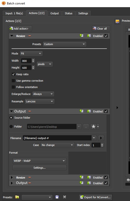

- Posts: 48924
Re: Run different actions for different watched (hot) folders
but what would be the best way to stack Action/Output in the UI?aiujb89 wrote: Wed Mar 16, 2022 5:55 pm For a future feature, please consider combining the Input steps with the Output steps so the user can decide what order to use them in. Then I could stack the Input/Output tasks repetitively to accomplish this task.

The software we previously used allowed us to "drag" either an input or an output into a "queue". So we could add 3 inputs, then an output. Then another input, then an output, for example.
The other option is to allow multiple "outputs" in the queue at the same time. So, after the inputs have all run, then it will run multiple outputs in order, each delivering a specific file format & name into folder(s) specified.
- Posts: 48924
something like that?

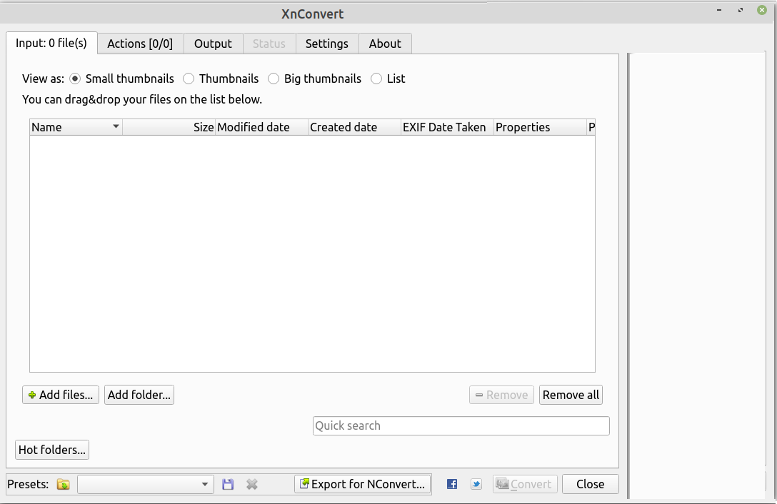

Recognising the unfulfilled need for a solution, I have recently been thinking about an alternative possible interface which would, if it can be implemented, enable completely unrestricted output of multiple versions of a set of inputs, and importantly do so in a way that would not change the present, very attractive and intuitive design of the tool when it is used in the present way.
The idea does depend on it being possible for activation of a setting on (for example) the Settings tab to change the already-open user interface so as to open a panel that could contain whatever controls are required to configure multiple alternative actions and outputs: those controls are a detail, and I can see alternative possible detail design options, the immediate question is whether there would be any "show-stopper" that would prevent implementation?
The required multiple output controls would be placed on the new interface area on the right: the question is, can the interface of an opened program be changed to add a new panel to the right...

Thinking about this idea recently, I started considering how an interface that would allow multiple, completely independent, actions and output 'threads' processing the same input files, might be configured. But I wasn't sure whether it was possible to expand an already open interface?
I had some outline ideas on possible alternative interface designs, but delayed posting them as I thought you would currently be fully occupied perfecting XnView MP...
If you can confirm that an open XnConvert window could be expanded as illustrated above, I will post some initial thoughts when I have time.
To recap: When the existing standard XnConvert interface is open, on selection of a new setting, the expanded interface above with suitable configuration controls added would open. And when finished running the configured multiple parallel 'threads', changing the same setting would restore the standard XnConvert interface.

i don't seecday wrote: Tue May 03, 2022 11:35 am To recap: When the existing standard XnConvert interface is open, on selection of a new setting, the expanded interface above with suitable configuration controls added would open. And when finished running the configured multiple parallel 'threads', changing the same setting would restore the standard XnConvert interface.
- Posts: 4622
Not possible, or not an interesting suggestion?xnview wrote: Tue May 03, 2022 2:12 pmi don't seecday wrote: Tue May 03, 2022 11:35 am To recap: When the existing standard XnConvert interface is open, on selection of a new setting, the expanded interface above with suitable configuration controls added would open. And when finished running the configured multiple parallel 'threads', changing the same setting would restore the standard XnConvert interface.
If it is technically possible, I think it could potentially provide a very flexible way of meeting the regularly-requested general need, and do so without in any way compromising the existing very attractive and intuitive basic interface? A suitable user interface to be defined, of course, I have some ideas.
- Posts: 48924
i'm always interested
i don't understand your idea
