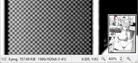

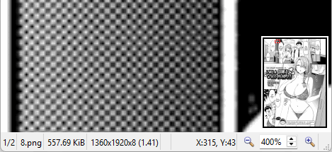

Posts: 2667
Re: 1.6.1 Unsharp/blurry picture zoom out
8bit is blurry and shifted to the top left by 1px with all filters except Bilinear,
eg Lanczos 4 at zoom 400%:

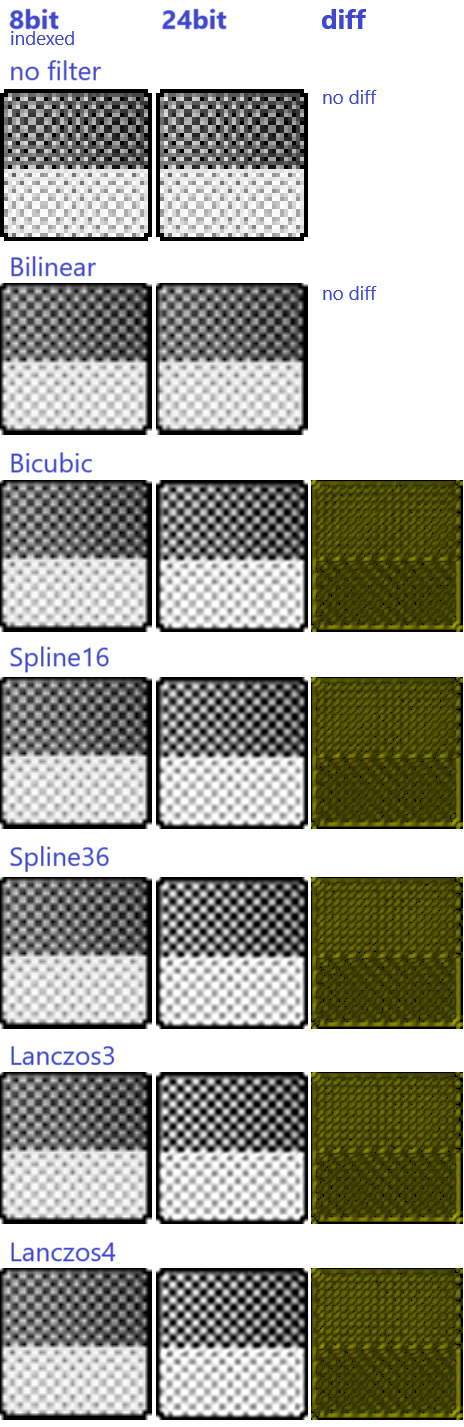

Posts: 2667
xnview wrote: Mon Feb 17, 2025 10:41 am Lanczos & bilinear dont use same process, and you can have small difference. But i means the original problem, blurry when 8bits and not in 24bits?
OP's issue is with zoom-out filters, but imo zoom-in is easier to test
I compare 1filter against 2images (8bit-indexed and 24bit), not filter vs filter
tests
0. win dpi scale - 100%
1. open test image
2. zoom to 400%
3. select zoom-in filter
4. make screenshot (24bit png) and crop accordingly
5. repeat for each variant and compare with Beyond Compare or by eye as difference is very noticeable
results
Bicubic, Spline and Lanczos filters make 8bit-indexed (comparing to 24bit):
1. much blurrier and
2. shifted to the top left corner by 1px
test_img+results.zip
(393.73 KiB) Downloaded 207 times
ps. I assume filter:none = Nearest neighbor ?
