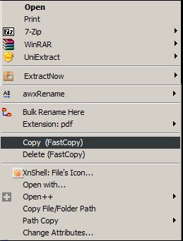

hello xnview community!
i like to report a gui bug for xnview shell extension, tested v3.4 and current v3.5 on win 7, the alignment is not the same with the other context menu, causing a space before the xnview shell icon, and also makes the other context menu icons to have a space after their respective icons. kindly see attached image. thank you for you great context menu!
- Attachments
- xnshell misaligned icon
- xnshell_prob.jpg (17.85 KiB) Viewed 16152 times
