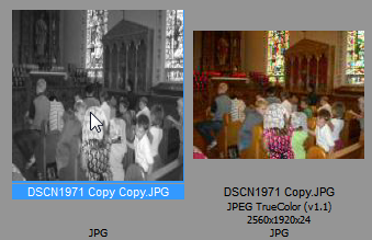

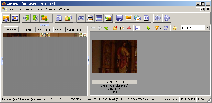

xnview wrote:are you able to reproduce?
I'm able to reproduce some of it some of the time, …
  • Mixed thumbnail sizes in browser
  • Hex in preview
  • Misc. weirdness (see attached screenshot)
… but none of the JPEGs were corrupted during my tests.

However, I am still able to corrupt those photos.
I went to the directory with the photos
made a copy of one in XnView's browser
then opened it XnView
set the saturation to 0
double-clicked to return to the browser (which would auto-save)
and voila! Corrupted image again.
Posts: 6549
Re: Effect Corrupts Jpeg File
XnTriq wrote:With your configuration, the overlay icon isn't displayed although Use Embedded thumbnail is activated.
Tools » Options... » Thumbnails » Icon info » Embedded thumbnail was deactivated.

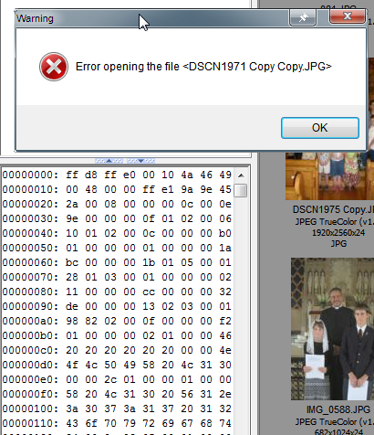

I analyzed the sample which is supposed to be damaged (DSCN1971 Copy Copy.JPG) with a whole slew of other specialized tools, …
… but all of these utilities confirmed JPEGsnoop's diagnosis: Everything seems to be in perfect order.
As mentioned earlier, I've been “able to reproduce some of it some of the time”, but I never ended up with a corrupted JPEG, even though I've tried to reproduce the problem on several different computers over & over again, which makes me wonder if this phenomenon only occurs on machines with the horsepower of Br. Gabriel-Marie's PC (“30GB RAM and an Intel Core i7-2600”).
@ Br. Gabriel Marie: If I understood correctly, …
Brother Gabriel-Marie wrote:I went to the directory with the photos
the edited JPEG is displayed as hex in the preview pane, and the thumbnail in the browser is distorted. What happens if you then…
  1. Point the browser to a different folder
  2. Deactivate Keep current image in cache in Tools » Options... » View » Misc. » Cache
  3. Remove the directory with the corrupted file from the list in Tools » Options... » Thumbnails » Cache » Cache maintenace
  4. Return to the original folder
  5. Try to open the corrupted photo

Well, as I've said, it doesn't happen with every jpeg file. Just certain ones (but consistently for those files).
The only other thing I can think of is that I am running Intel Smart Response Technology (ISRT) and have used an SSD to accelerate my C drive HDD. I've also put my pagefile onto that SSD. Those two things provide my system with 15-20 more responsiveness.
So I applied the settings you indicate and I am still able to corrupt the jpeg.
And I can still corrupt the jpeg even if I move the file to another folder on another partition.
If I try to open the corrupted jpeg, I get a popup from XnView saying, "Error opening the file <myfile.jpg>"
