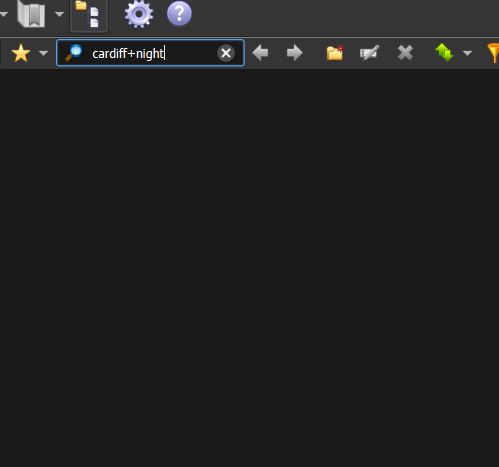

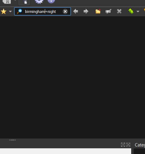

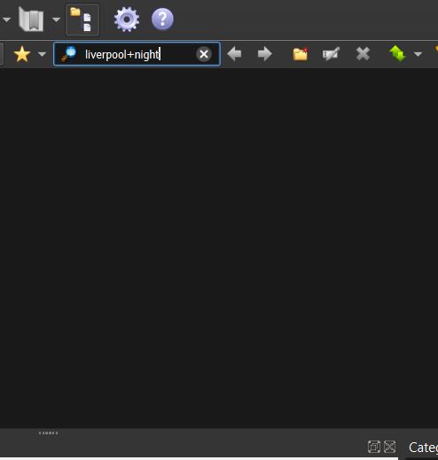

Attached four files. All four are tagged 'night'. Each one is tagged with a different location: Hidcote, Cardiff, Birmingham, Liverpool. All four locations also have images not tagged night (effectively the daytime shots - I tag night shots but don't tag daytime shots).
If I Quick Search 'night' all four are found in the results. If I search by one of the four placenames in turn, each one is contained within the respective results set. If I search using night+placename then nothing is found.

Ok, i understand, it works for 'Night+Birmingham' and not for 'Night+Cardiff' because Cardiff is Places>Cardiff & Night>Cardiff, i fix it
Thanks to your detailed description I can reproduce the problem.

I see what I have done. I have checked the four images:
Birmingham is tagged Birmingham, Night (but not Night>Birmingham)
Cardiff is tagged Cardiff, Night (but not Night>Cardiff)
Liverpool is tagged Liverpool, Night, Night>Liverpool
Hidcote is tagged Hidcote, Night, Night>Hidcote
I do not know why I did this. In any case, none of the Quick Searches using + work.

Re: Quick Search in Categories
it works with 'Night+Birmingham' not 'night+birmingham' (same with 'Night+Hidcote')roadcone wrote: Tue May 18, 2021 3:07 pm I do not know why I did this. In any case, none of the Quick Searches using + work.
