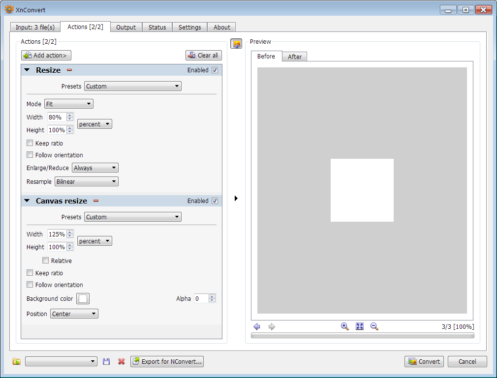

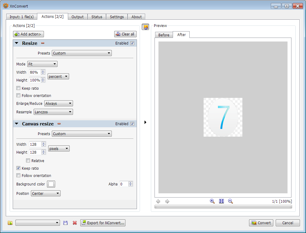

At a quick look I think so:
You had better check carefully.
Edit:
I don't know why there's a black line around the image -- it's not shown in the screenshot 'After' display?
So maybe almost, or can that be fixed??

cday wrote:I don't know why there's a black line around the image -- it's not shown in the screenshot 'After' display?

Thanks, I just opened the image in an image editor as an afterthought to check that and found that! But why is there a black border on the image I uploaded and not on the example images that were uploaded originally -- both viewed with the same forum settings?
*Note on the XnConvert settings in the screenshot above: some of the detailed settings such as the resampling method used may not be optimal.*

cday wrote:At a quick look I think so:
Edit:
Yes, that would work for this size, but imagine if you have several files with several sizes (ex. 128x128, 256x256 and 512x512) and want to convert all of them in one step? My solution is more generic, because it would work for (almost) all files in the batch, regarding their sizes, but it works only for square pictures and the point is to change the content without changing the background (canvas size), so the program can transform as many files in batch as possible, regarding their size and form (square or rectangle).

philippetev wrote: ... imagine if you have several files with several sizes (ex. 128x128, 256x256 and 512x512) and want to convert all of them in one step
A modification then, but I'm not sure that it quite meets your needs:
In the second action 'Canvas resize' rescaling the width and the height using percentages would ideally extend the process to the pixel dimensions you quote, or to any other dimensions. But there is a problem: rounding errors in the calculations sometimes result in pixel dimension very slightly different from the nominal rescaled value.
128x128 --> 127x128
256x256 --> 255x256
512x512 --> 511x512
I tried changing the width by 126% rather than 125%, for example, but that didn't produce a general solution for varying initial image sizes as the required correction changes with the image size. It isn't possible to enter decimal values.
If the transformed pixel dimensions must be *exactly* nominal then I don't see a way of obtaining that using XnConvert.
