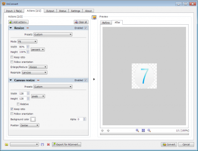

I've managed to accomplish similar effect, applying Resize, set to width 75% and height 100% and Canvas Size, set to Width 134% and Height 100%, but the Canvas Size width is different for the different picture sizes, which force me to try several combinations before the actual process.
Posts: 4623
Re: Transform ?
At a quick look I think so:
You had better check carefully.

Posts: 6580
Re: Transform ?
cday wrote:I don't know why there's a black line around the image -- it's not shown in the screenshot 'After' display?

Posts: 4623
Re: Transform ?
Thanks, I just opened the image in an image editor as an afterthought to check that and found that! But why is there a black border on the image I uploaded and not on the example images that were uploaded originally -- both viewed with the same forum settings?
*Note on the XnConvert settings in the screenshot above: some of the detailed settings such as the resampling method used may not be optimal.*

cday wrote:At a quick look I think so:
Edit:
So maybe almost, or can that be fixed??
Yes, that would work for this size, but imagine if you have several files with several sizes (ex. 128x128, 256x256 and 512x512) and want to convert all of them in one step? My solution is more generic, because it would work for (almost) all files in the batch, regarding their sizes, but it works only for square pictures and the point is to change the content without changing the background (canvas size), so the program can transform as many files in batch as possible, regarding their size and form (square or rectangle).

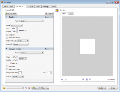

Posts: 4623
Re: Transform ?
philippetev wrote: ... imagine if you have several files with several sizes (ex. 128x128, 256x256 and 512x512) and want to convert all of them in one step
A modification then, but I'm not sure that it quite meets your needs:
In the second action 'Canvas resize' rescaling the width and the height using percentages would ideally extend the process to the pixel dimensions you quote, or to any other dimensions. But there is a problem: rounding errors in the calculations sometimes result in pixel dimension very slightly different from the nominal rescaled value.
128x128 --> 127x128
256x256 --> 255x256
512x512 --> 511x512
I tried changing the width by 126% rather than 125%, for example, but that didn't produce a general solution for varying initial image sizes as the required correction changes with the image size. It isn't possible to enter decimal values.
If the transformed pixel dimensions must be *exactly* nominal then I don't see a way of obtaining that using XnConvert.
128x128 --> 127x128
256x256 --> 255x256
512x512 --> 511x512
That was exactly my point, the Canvas percentage should be determined with trials/errors every time and the technique is completely useless for non-square pictures (ex. 168x140).
Posts: 4623
Re: Transform ?
philippetev wrote: ... the Canvas percentage [needs to be] determined with trials/errors every time ...
The first method worked exactly with the image you uploaded, and the second method would work exactly for any image dimensions if the width calculations were more precise, but no, if you need the transformed image to have identical pixel dimensions neither method is usable at present.
philippetev wrote: the technique is completely useless for non-square pictures (ex. 168x140).
A similar rescaling technique could also be used for the image height, but whether that would meet your needs if the calculations were more precise I don't know.
The fact that applying a percentage change to the image canvas dimensions and then in a subsequent Action applying the inverse percentage change doesn't always restore the exact canvas dimension might be viewed as a bug, and could probably in principle be corrected.
Posts: 48940
Re: Transform ?
Bug confirmed and will be fixed. See issue Issue 188 for current status and details.
