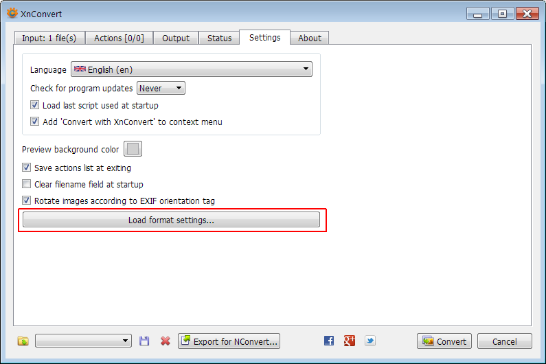

If GhostScript isn't the problem, could you please try these setting:
XnView software is for some reason less tolerant of slight malformed PDF files which often open normally in other PDF software.
