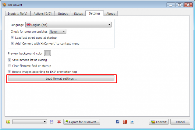

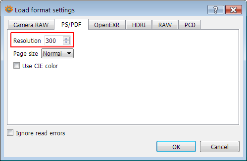

To obtain a good quality image, you may need to increase the DPI value used when PDF files are opened from the default value of 72 to a higher value:

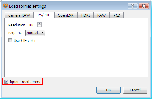

If GhostScript isn't the problem, could you please try these setting:
XnView software is for some reason less tolerant of slight malformed PDF files which often open normally in other PDF software.
