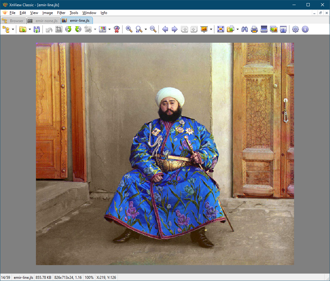

XnView 2.49.2 can display "line" and "sample" correctly, but "none" is displayed as 9 small images:
(see attachment).
by line is displayed correctly as:
Note: irfanview has the same problem, the Accusoft PICTools Apollo demo viewer shows both images correctly.
