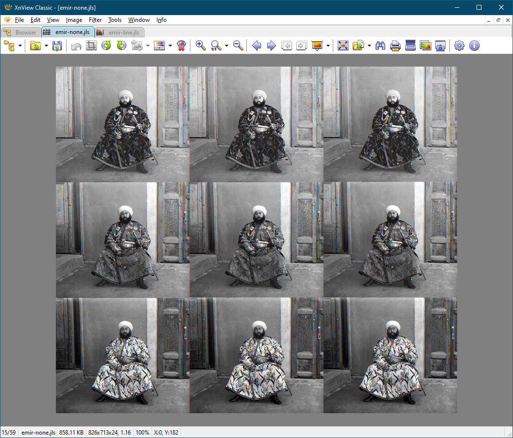

XnView 2.49.2 can display "line" and "sample" correctly, but "none" is displayed as 9 small images:
(see attachment).

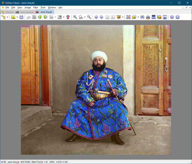

by line is displayed correctly as:
Note: irfanview has the same problem, the Accusoft PICTools Apollo demo viewer shows both images correctly.
The source .JLS files are attached.
