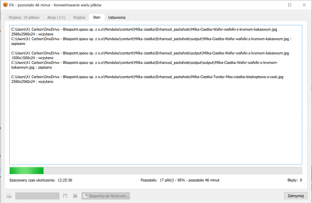

I have similar problem on Windows 10 and XnViewMP 0.97 - batch conversion takes minutes vs. seconds. Could you help me understand how to solve it?
Example - I started batch resize of 17 jpg impages each around 1.5-2MB and it estimates the time to 40+ minutes!

Pierre has identified the cause and it will be fixed in the next version 0.97.2, when it is released probably sometime in the next few weeks...xnview wrote: Mon Oct 19, 2020 3:19 pmThanks to your detailed description I can reproduce the problem.
Relate to issue 1856
