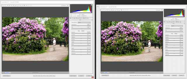

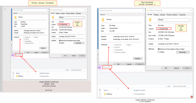

attachment shows a preview by Directory Opus (left) and XnViewMP latest version, right.

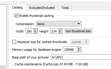

please check Settings>Catalog>WidthxHeight

A Compression setting that results in sharper thumbnails: Lossless (ZIP) or a higher quality Lossy option ??mrwul wrote:? Okay, but then what?xnview wrote:please check Settings>Catalog>WidthxHeight

It is set to 'None
set to lossless zip and also tried high quality jpeg
does not make any difference
(closed and relaunched XnViewMP in between)

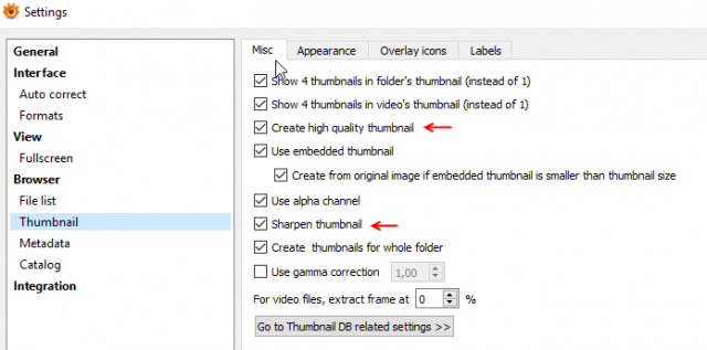

Ah, you asked originally about sharpening, and I see that in XnView MP that option can be found in Tools > Options > Browser > Thumbnails -- Misc tab

Yes, I clicked rebuild.cday wrote:And you clicked on Rebuild thumbnails ?mrwul wrote:It is set to 'None
As for sharpen, that has been 'set'
