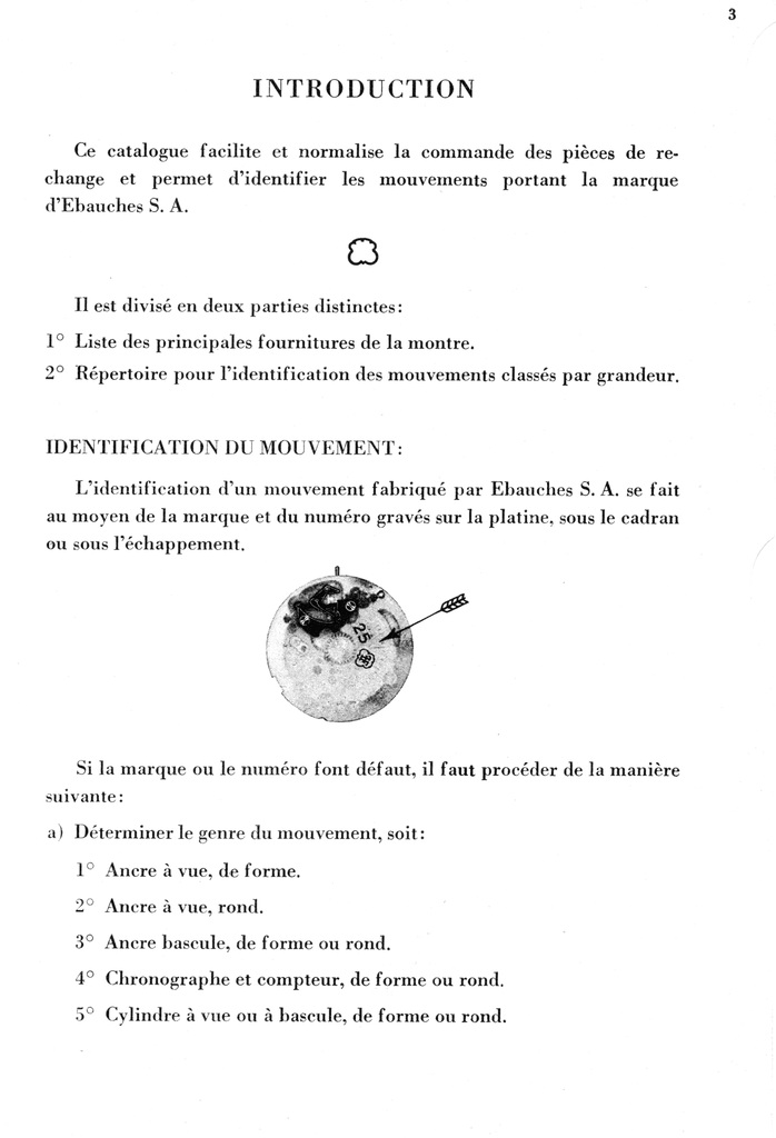

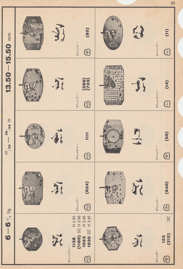

I create PDF files from old scanned books and reference catalogs. These books often have yellowed pages, or darkened with age. Do you have tips on how to best improve the look of the pages?

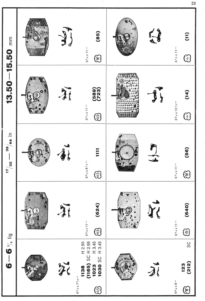

My attached files are the original scanned page that has a brown background that is partly from age and partly from the color when it was originally printed. The processed image has the background whitened, with what I think are minimal impacts to the page contents. It's important that the pictures or drawings not lose detail. My files are all PNG but needed to compress and convert to JPG for posting.
My script that processed the attached image looked like this:
  • Gammasat 0.17
    Levels Black point = 62, White point = 218
    HLS. Hue = 0, Lightness = Lightness = 2, Saturation = -6
