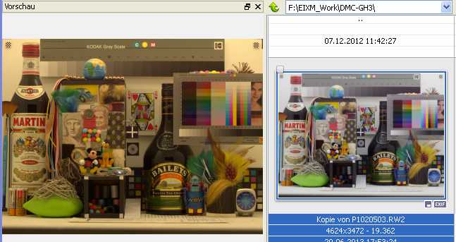

Because I have the plan to buy a Panasonic DMC-GH3 camera I downloaded some example-images from internet:
e.g.: http://movies.dpreview.com.s3.amazonaws ... 03.RW2.zip
For images taken with that camera I have seen that the preview-image and the thumbnail-image have a different hue (see attached screenshot).
I also know about a similar problem with DcRaw.
- the preview image looks like an output of DcRaw version 9.16 and
- the thumbnail looks like an output of DcRaw version 9.17.
Has XnViewMP a similar problem?
Best regards
Herb

Re: Hue of DMC-GH3 images
XnView use DCraw so same problem, but you can change settings to open embedded jpeg
oops66
- Posts: 2016
...But maybe an icc profile/filter, already exist to correct the problem ?
(Settings\General\ICC\Default profile of picture\Other .... custom-file.icc)
PS: ... It's better with this customized attached icc file
