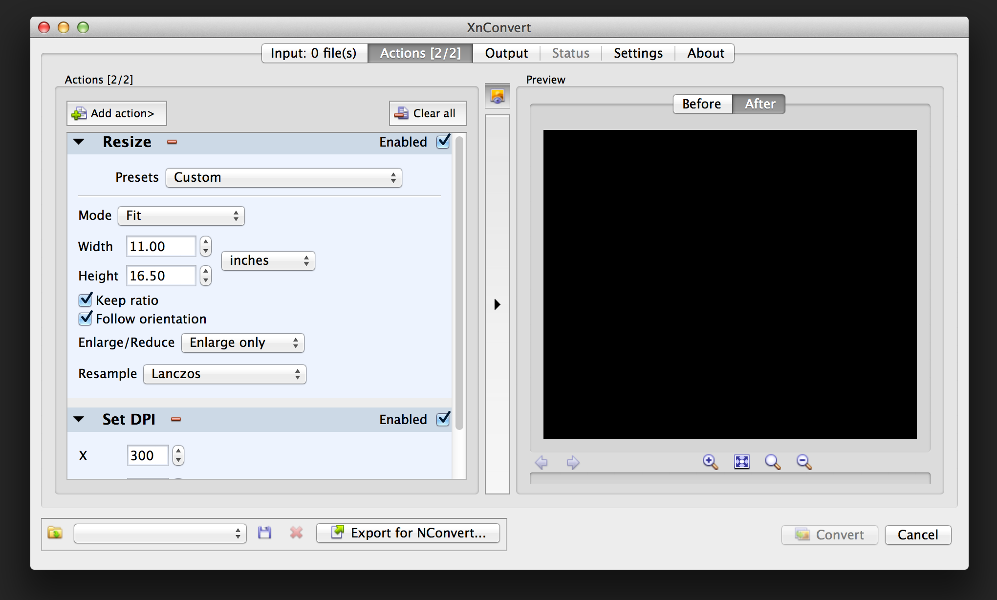

this is what i'm typing in the sizing section. it just keeps the images the size they already are, not sure if a setting is off?
11 x 16.5 inches

it does not fix the issue - still makes it a random size, not the one i'm typing in.

I think I've found a bug in the XnConvert 1.60 Resize function which I'll post as a separate thread if confirmed.
If you were using XnConvert 1.55 (issued 12 March 2013) when XnConvert last worked, you may currently have two issues: an incorrect setting as you said that it worked before and a 1.60 bug which seems to make XnConvert run very slowly and produce incorrect, very oversize pixel outputs.

Re: resize option not working
Bug confirmed and will be fixed. See issue 220 for current status and details.
