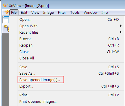

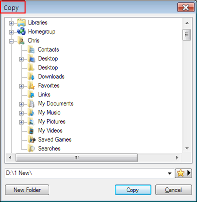

Edit: Is this possibly the problem?
The File > Save opened image(s)... window is titled Copy ...
And there is (surprisingly?) no option to select the file format to be used...
If your XnView interface is set to a language other than English, a screenshot in the language you are using might still be of some use, or you could possibly set the interface language to English temporarily to check the English text for the option to which you are referring.

Just prepared the screenshots, but you were faster - Many Thanks.cday wrote:A screenshot might help...
Yes that is my problem. I searched in the settings a possibility to define a default file format, but I was not successful.cday wrote: Edit: Is this possibly the problem?
