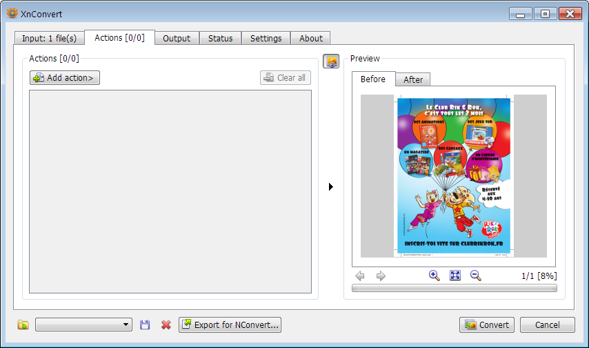

You need GhostScript http://www.ghostscript.com/download/gsdnld.html installed to open PDF files using Xnview software, 32-bit or 64-bit according to the version of XnConvert you are using.
Your file opens with XnConvert 1.55, I haven't checked with 1.60 but it should be the same.

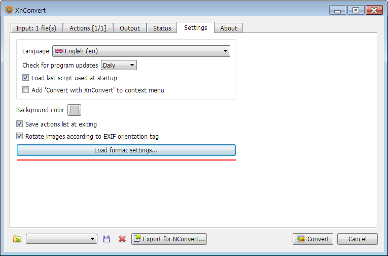

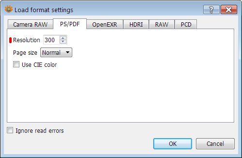

XnConvert opens PDF files using a default DPI value of 300, this value can be changed if necessary as follows:
In general, higher DPI values produce higher quality images but also larger file sizes.
