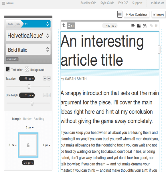

Why do I get a bigger file size after decreasing the image size?
This is the base file:
http://s23.postimg.org/chc1had17/from.png
its size is 100.2 kB
after the resize: 179.8 kB
resample: lanczos
if I choose the "nearest neighbour" resample option, then the file size is smaller, but there is a huge quality loss.
kinda strange for me :shock: :D

I left the "Format" at "as original". If I change it now to PNG, the compression level is at 6. It looks like even if I change the compression level to 9 it is only a small change in file size.
However, that color depth change makes a huge impact. This is a great trick! I see the quality loss at the top of the image, but still pretty good.
These are the results:
result size(this is the needed size): 580x600
PNG6: 179.8 kB
PNG9: 178.2 kB
PNG6+color256: 60.7 kB
PNG9+color256: 59.2 kB
How did you make that 30kB? :)

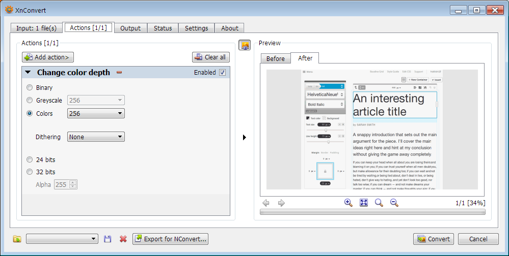

I don't think so if the optimum settings are used: I've now managed to use XnConvert to reduce your image to 256 colours and obtain the same 30KB file size as before:
from_XnConvert_256.zip

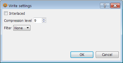

I used the following XnConvert settings:
I'm not sure whether Dithering -- None and Filter -- None are actually the ideal settings but they give you a basis for any further tests you may wish to make.
Adding a Resize step seemed to increase the file size, which seems counter intuitive as the resulting image has smaller pixel dimensions, but possibly results from an increase in complexity in the image. Note that the 580 x 600 pixel size image you wish to create has a slightly different aspect ratio from your orignal image, and that selecting or not selecting 'Keep ratio' affects the image produced, so you may need to examine that. Edit: use 'not selected' to obtain the pixel dimensions entered.
Also note that the Resize step produces a 24-bit colour image, and so the reduction in colour depth to 256 colours must be the final step.
