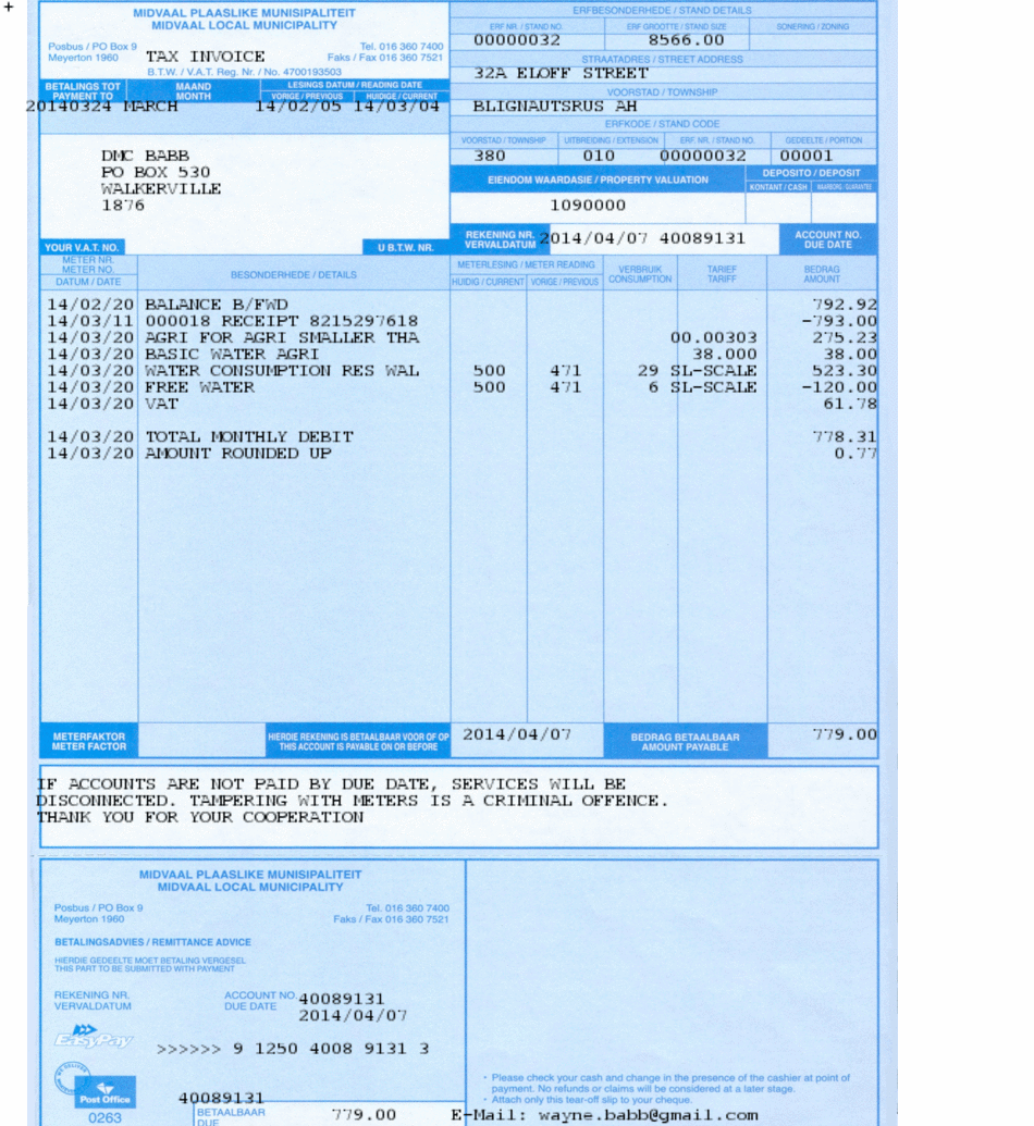

If you would like to experiment for the best solution to my problem, I've tried to attach a sample, and hope you can retrieve it.

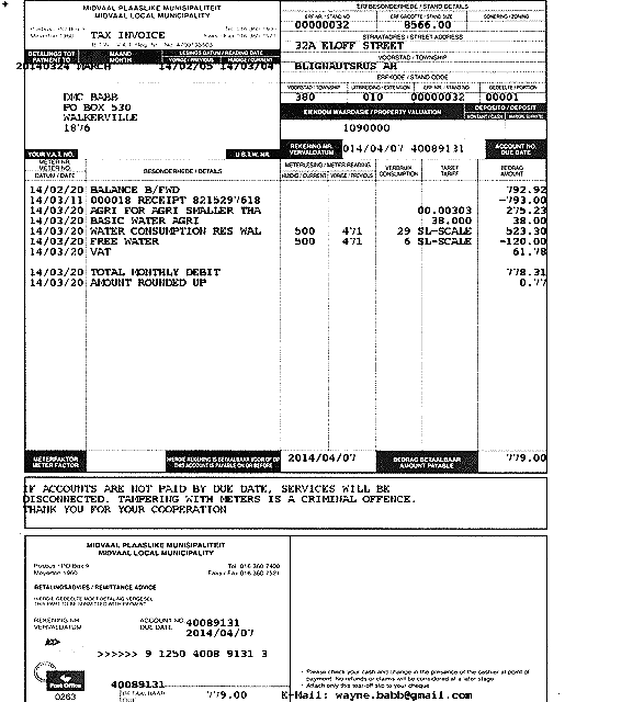

The dark blue does complicate things a little, and the bill appears to have been printed using a low-tech dot matrix printer which doesn't help, and the image pixel dimensions are quite small...
But to show you that it is possible, I'm ataching the result of a quick test that used a series of operations too experimental to document immediately, but I'll do some more tests later and post again.
A challenge for anyone else with time to spare...

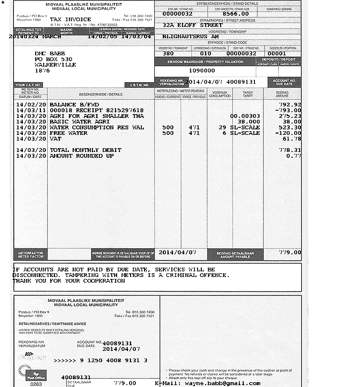

Here's another one: The file size has increased substantially, which I imagine is of no concern to you, because I've resampled the orignal blue image to higher resolution, and also because of the shades of gray which I've left in.
The question is whether this is worth persuing if you will have to carry out a series of operations on each bill you receive?
And it probably depends to some extent on the printer you are using.

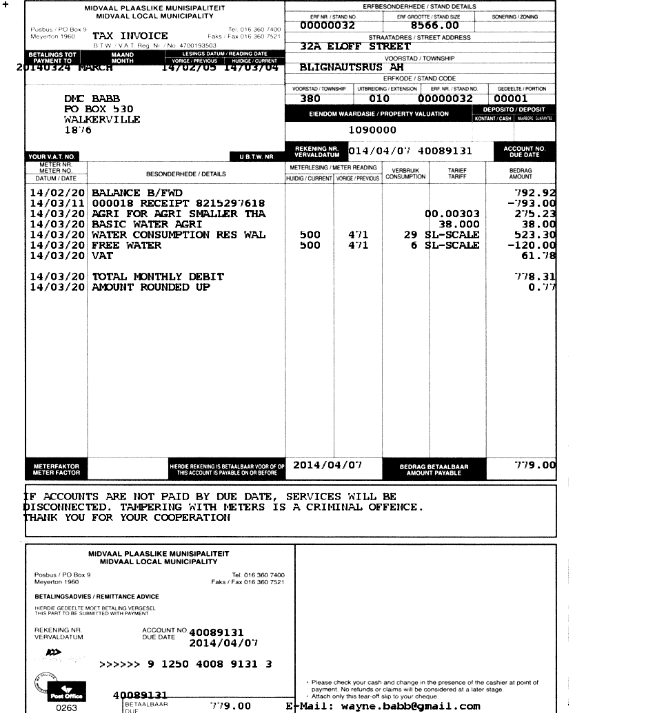

Here's my stab at it in as few steps as possible:cday wrote:A challenge for anyone else with time to spare...
- Image » Convert to Grey » 256 Grey scale
- Image » Adjust » Levels » Black point: 153 / White point: 204

And...
3. Filter >> Effects >> Enhance -- (one of the Focus options)
You posted about it yesterday and it really is amazingly effective...
Why don't you post an image?

Updated!cday wrote:Why don't you post an image?
Edit: You're right, applying one of these filters does increase readability (and decreases color count plus file size)
- Filter » Effects... » Enhance » Enhance Focus
