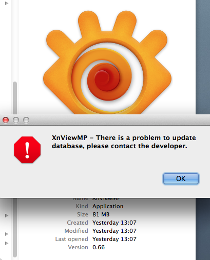

Hi
I just updated and replaced XNMP with the latest version in my apps directory - Mac OSX 10.9.2. Ran app and got this error message - HELP PLEASE!
Cheers
tony

I have the same problem but with XnViewMP 0.67 x64 on Win7 x64..
I try to update from 0.64 to 0.67 and get the same message as above.
"XnviewMP - There is a problem to update database, please contact the developer"
(PS: My DB is too private to share but I would contribute any other way to fix this)...

With 0.68 I still can't update. Now I get an "Error: 11" in the message popup.

I also got this error on mac os X
Had 0.64 running fine.
This is the screenshot of the error:
http://sintjansberg.be/downloads/_20140 ... 213833.png
Do I send you the db?
