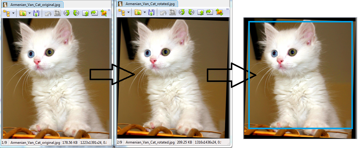

That is what I'm trying to automate:
Posts: 4537
Re: NConvert AutoCrop option after Rotate doesn't work
That's an excellent illustration that makes the problem clearer. :)
The first operation is a small rotation: do you want to automate that, using a fixed rotation angle, or to do a custom rotation for each image and then use NConvert for only the second operation?
The second operation could only be done using autocrop if the image is straightened first, as in the image I posted: autocrop crops each edge of the overall image in to the start of the image itself, and so produces a rectangular crop as if you had made a manual selection. You have probably seen that, but that is the way autocrop works...
The second operation as shown could be done as a simple crop using NConvert, but only if the same pixel settings could be used for each image.
A better solution would probably be to use -canvas , with the position 'pos' set to center : if the 'percent' option is used it should be possible to process images with different pixel dimensions using the same resize proportions.
