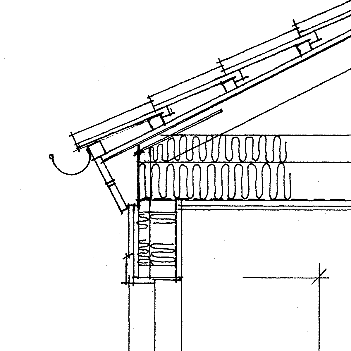

Is there some contrast setting or other way to make PDF files that I output darker? The incoming CAL files are very light and hard to read. Is there some setting I can play with to make the type darker? Thanks.

mrjacoby1 wrote:Thanks for the suggestions, but they don't seem to work on my .CAL files.
Your .CAL files were engineering drawings and likely to be black and white images with 1-bit per pixel: that would I think invalidate all the suggestions above. You can confirm the bit depth by looking in the status bar at the bottom of the screen, or using Edit > Properties.
If the images are black and white, I suspect that the lightness you're experiencing is due to the large pixel dimensions of the images, with fine lines not displaying well on your screen, which almost certainly has a much lower resolution. You could check that by zooming well in and seeing if details in the image are then well defined.
If both the above are confirmed, you will probably need to think about how the images are to be used in practice, either zooming well in when needed, using a higher resolution and probably larger screen, or by printing the files. It might be possible to resample the images to thicken details, but I wouldn't expect that to be a good solution, although you could try.

To your first point: Yes, 1 bit per pixel. When zooming in, the letters are very well defined.
Posts: 4563
Re: Is it possible to make converted files darker than origi
mrjacoby1 wrote:To your first point: Yes, 1 bit per pixel. When zooming in, the letters are very well defined.
Given that the pixels are already pure black, I don't think any of the previously mentioned enhancement methods will improve the images.
Well, you have the options listed above depending on how you actually need to use the images: you could simply zoom well in when needed, obtain a better monitor such as the recently released but expensive '4K' monitors with around twice the number of pixels (without checking), you could possibly print the images, or just possibly resample them successfully but remembering that you would be changing an engineering drawing slightly...
Another possibility might be to crop out areas of the image of interest and save them as more-viewable images.

Since I wasn't familiar with this file format and because I didn't have any samples, I failed to realize that CALS images are always binary (black & white).
Let's give it another try:
  1. Image » True Colour
  2. Filter » Effects... » Misc. » Minimum (Filter size: 3x3)
  3. Image » Convert to Binary » Binary (No Dither)
