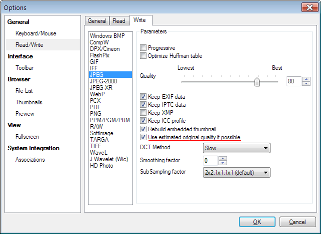

The XnView Image > Resize function provides a means of of changing the pixel dimensions of an image, either increasing or decreasing the dimensions according to the settings used. When 100% is selected the pixel dimensions are unchanged, as you say.Phred wrote:Jpeg photos here imported from an iPhone 4 can be resized by XnView, by '100%', becoming files of half their former size - without any apparent visual or dimensional changes.
Each photo of a pair carries the same number of pixels (H & W) and the same colour depth, yet 90% of the time, one of the pair is about half the size of the other. And each looks the same as the other.
The differences in file sizes after using Resize you report are likely due to the settings used when you saved the images after resizing them: primarily the compression factor 'Quality' selected, and also possibly the other detailed settings available in the File > Save as... 'Options' menu below.
As a quick test, you could try saving an original image directly with the 'Use estimated original quality if possible' option underlined in red selected, which may well result in a file size close to the starting file size.

Thanks for the suggestion, cday, but - no. Nothing much changed.
I tried again with the exact set of jpeg options that you illustrated, even on a different set of originals, and the proportions were about the same.
42 MB for 24 files versus 24 megs for the same 100% resized output.
In fact, with nothing [ ] for the parameters in the resize width and height - empty, zero, zip in the boxes, the resultant anomalous resize was the same. Strange code in there...?

Your primary aim is to minimise the file size of your IPhone JPEGs without any perceptible loss of quality, or presumably metadata?
It isn't entirely clear why you first used the XnView Resize function, presumably because you believed that it was a function provided to reduce the byte size of files? And you have continued using it because it does, incidentally, reduce the size of your iPhone JPEGs?
The one setting you haven't referred to above is the save 'Quality' setting: saving at a lower value is the most obvious way of reducing file size, and arguably the most obvious explanation for the file size reduction you are seeing unless you have been saving at 100% Quality.
The JPEG format is a lossy format, but for colour images it is almost the only practical format available when file size is important. But inherently lossy as is, photographic images often compress very well with no perceptible loss of quality. So you might explore that if you haven't considered it already; one caveat, though, would be to leave some margin to allow for the possibility that future higher-resolution screens may show defects that aren't visible at present day screen resolutions.
The halving of file size you are seeing after opening and saving an image in XnView is a mystery unless the images are being saved at a lower quality, with no visible loss, than the original images. It could be easily explained if your images were 48-bit colour, as XnView only supports 24-bit colour, but the JPEG format doesn't support that bit depth, even if your iPhone camera did...
Do you have an original image you could upload for inspection? The forum attachment size limit is currently 1MB, so that may be a problem, alternatively you could possibly upload an image to a file hosting service in the cloud and provide a link.
