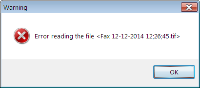

Additionally.. i just tried the CONVERT button... to PDF.. and got the attached error..
What am i doing wrong? unless the program d/n allow for easy conversation from TIF to PDF...
My faxes are received as TIFF.. I wonder if I can change the default file type for the fax program to PDF..
Either way.. How do I fix the XNView issue? It's weird, eh?
Thanks in advance

Posts: 4465
Re: "error reading the file <>" - Can't save or export
You want to save (or export or convert) TIFF files that are black and white directly as PDF files?
I've done a quick test and didn't have any problem saving a black and white TIFF directly as a PDF file with either FAX or JPG compression -- in the File > Save As... menu you can use the Options button to select the type of compresion used, but as far as I know any option should work.
So basically it seems like I can't Save the TIF file as a PDF.. is there a plugin needed?
Do you have Ghostscript installed, x32 as XnView Classic is 32-bit software? It's required to open PDF files but I'm not certain whether it's also required to save to the PDF format, but you say you have managed that in some circumstances...
rbergmandc1 wrote:Might have just stumbled on something..
If I RIGHT CLICK on a TIF and say CONVERT INTO JPG... Then Click on that JPG and hit CONVERT on the MenuBar.. it saves a PDF no problem..
So it seems as if its a TIFF issue?
Saving the file as a JPG changes the bit depth from 1-bit (black and white) to 8-bit as the JPEG format doesn't support 1-bit images, so that might possibly be relevant, although I don't immediately see why...
I can upload the TIF if you like, but i don't think thats the issue?
That would probably be worth doing as we're rather short of ideas at the moment... :?

Posts: 4465
rbergmandc1 wrote:Attached is the TIFF i've been playing with.. see if it works on your machine..
Could it be some configuration error within XNV?
I can't open the file...
... but it opens correctly in IrfanView, which I believe automatically corrects some errors, so the basic issue may be an incorrectly formed TIFF file.
rbergmandc1 wrote:I don't have Ghostscript installed, but I can if you think it MIGHT help...
I have been meaning to check whether it is actually required to write to the PDF format as well as open PDF files -- I imagine it is -- but haven't done so yet; I would install it anyway to be covered and it would also be needed for the other program if you need to use it.
Posts: 6523
XnView should be able to open and convert the file if Ignore read errors (Tools » Options... » Read/Write » General) is activated.
