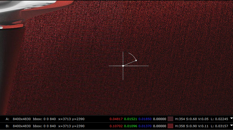

I am rendering the original JPG out of The Foundry's Nuke, and with a 4:4:4 sub-sampling setting. I have attached a screenshot, where you should be able to see a little difference between left/right of the crosshair. The right hand side is the original image with colors untouched. On the left hand side is the image which has had command #1 and #2 applied. On my calibrated monitor, the discrepancy is greater than in that screenshot.

could you send me the original picture file?
