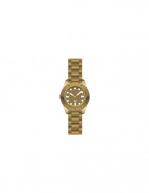

Thanks for the reply. I tried with following option -
nconvert -dpi 300 -truecolors -out jpeg *.pdf
But its not giving proper image quality (slightly better than non-dpi option). I am attaching the JPEG image generated with above command. Generated JPEG image is still missing those glossiness.
Can you please guide me for some other option? Any help in this is highly appreciated.
Thanks.
Thanks.

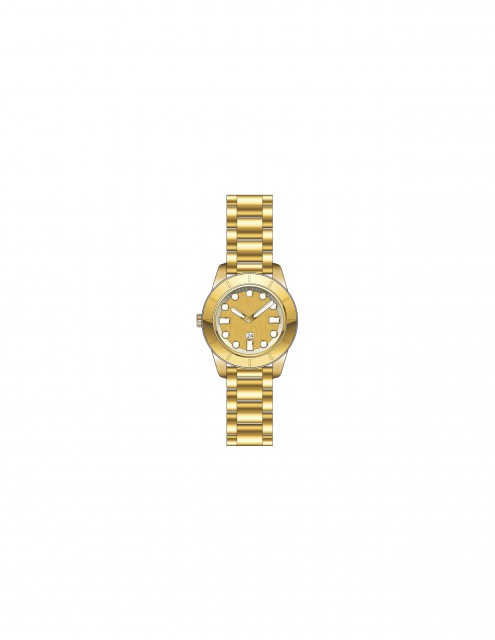

Confusingly, your exact script works for me:
Inspecting my image a_cday.jpg in XnView (the windowed program), the DPI is shown as 300 and the pixel dimensions are 2549 x 3299 px, whereas for your a_2.jpg image the DPI displays as ??? and the pixel dimensions are 495 x 640 px.
So it looks as if the DPI term in the script has not operated correctly on your computer: are you using Windows with Ghostscript installed, x32 for NConvert x32 or x64 for NConvert x64?
In addition, your source PDF opens normally in Adobe and XnView software, but in NitroPro it is displayed with a purple colouration, so there might also be an issue of some kind with the source file; the file properties indicate it was produced with Adobe Illustrator CS6, so that is perhaps more likely a NitroPro issue, although possibly it is a pointer to a subtle issue with the source file.

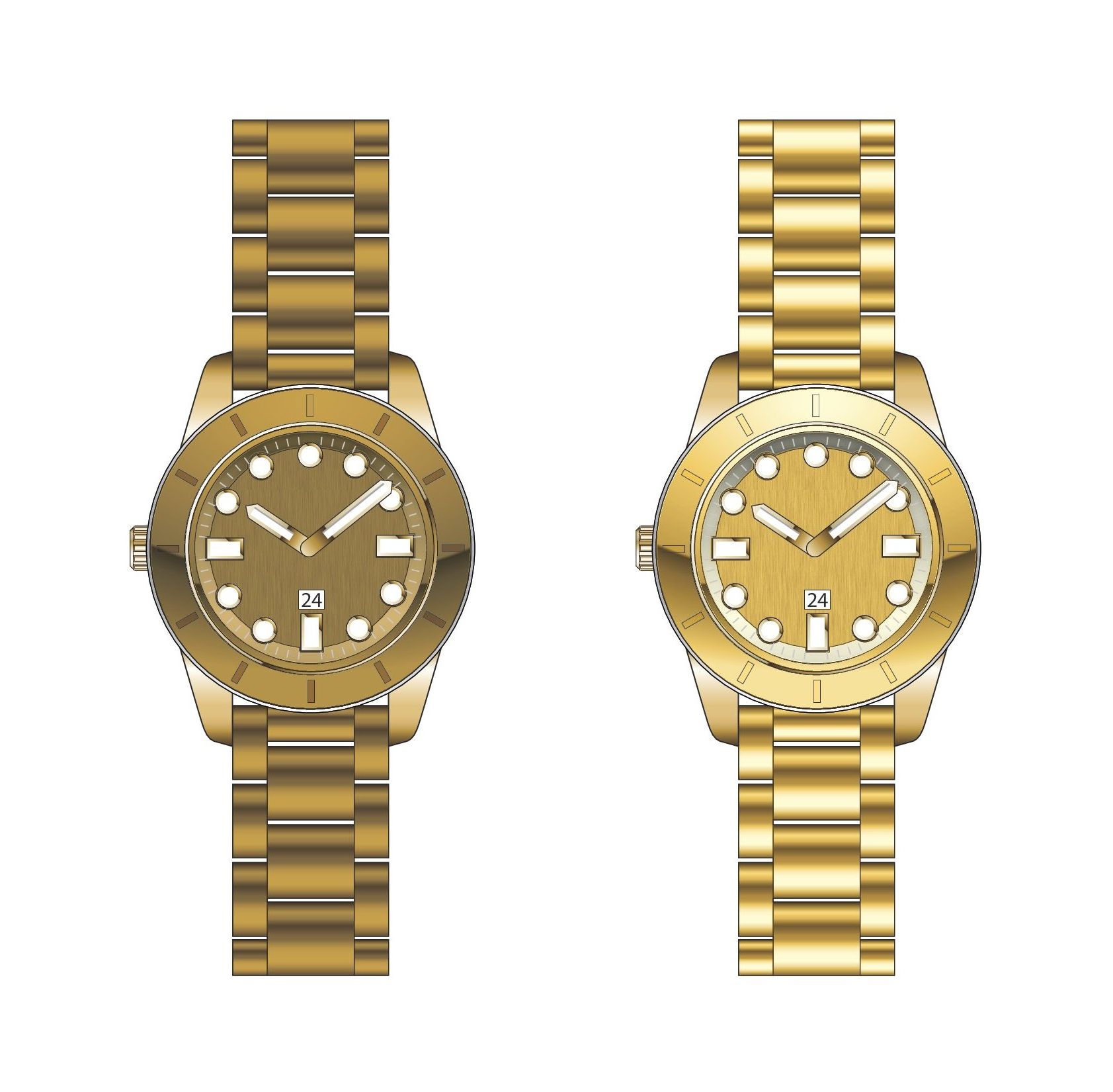

Comparing your command output with mine, firstly I also have ERROR: -101 so that likely isn't relevant, and secondly your ARG 10 image dimensions and ARG 11 DPI are in fact correct: I made the mistake of downloading your output image from the image displayed in your post, rather than the full size image displayed when the image is clicked...
The difference between my image and your image therefore seems to be the colouration:
So some progress, but I don't immediately have any further suggestions; I copied and pasted my command line directly from your post, and that is exactly the code you are running?
Possibly someone else can identify the issue, which can probably as well be investigated in one of the XnView windowed image programs in the first instance...
Re: PDF to JPEG Conversion - Image Quality is Poor
Standby: looks like a Ghostscript or possibly NConvert version issue, as I have now reproduced your image using NConvert 6.70 x64 and Ghostscript 9.16...
My original tests used older x32 versions of both programs, but I have now produced correct output using NConvert 6.70 x64 and an older Ghostscript version, but I'm running out of time and mental energy to investigate further at the moment. Perhaps you can do some systematic tests using earlier versions?
Update: The colourisation issue seems to be specific to Ghostscript 9.16, supposedly only a minor update...
If you uninstall 9.16 and install Ghostscript 9.15 your code should, with luck, work as intended.

Yes, There seems to be some regression with ghostscript version 9.16 and it works with earlier version. I need to check with Ghost script what is exactly wrong there.
