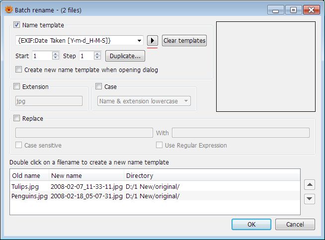

my problem is, that I am using different cameras and each one produces different file names;
so I want to rename the files, and I want to have only the creation date (including time) as file name without any additional number
then I have all the files in the right order and I could rename them again with an additional number
I spent a lot of time, but couldn't fix this problem

x-drahn wrote:... I am using different cameras and each one produces different file names;
so I want to rename the files, and I want to have only the creation date (including time) as file name without any additional number ...
Is this setting from the available templates not the answer:
Exif - Image > Date taken

thanks a lot
