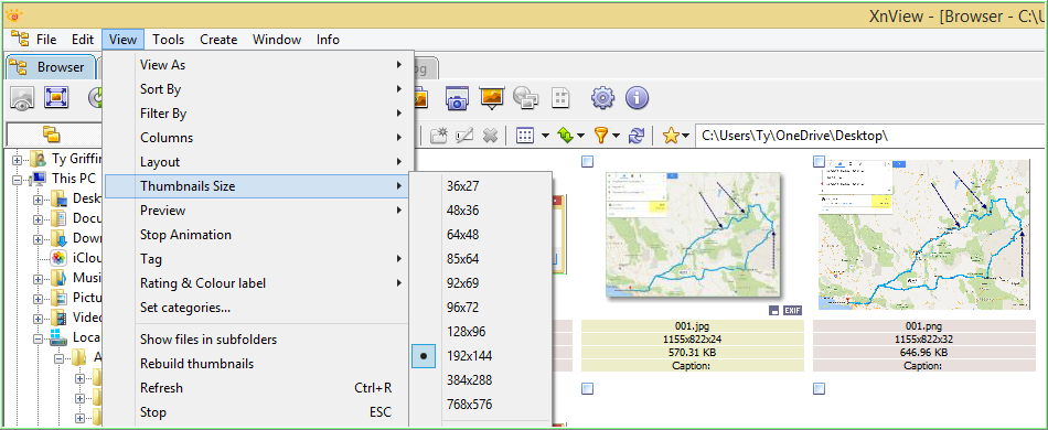

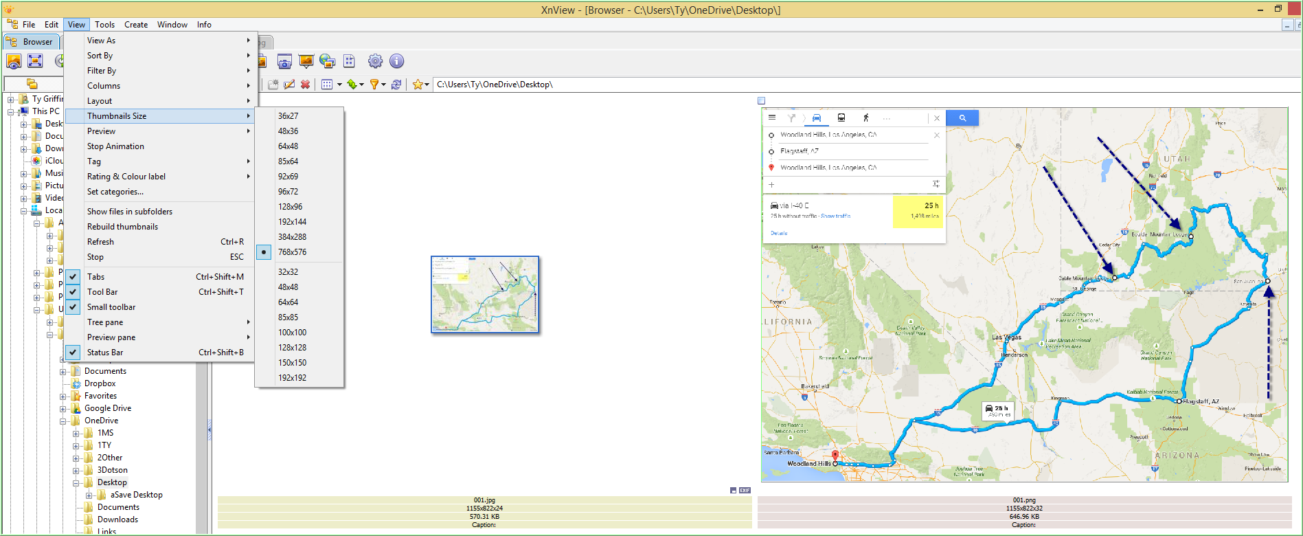

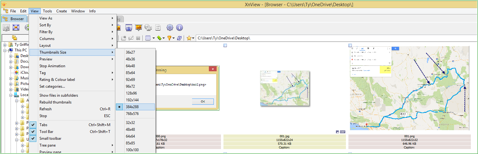

The problem is that when you change the thumbnail size to very large, the JPG images--only--stay at the same small size. Other image formats--at least PNG--grow as they should, but the JPGs stay the same small size.
Please see the attached three images which should illustrate the problem. Note that "001.jpg" and "001.png" are exactly the same image except for file format.
Thanks.
PS. Look at the images in this order: 005, 006, 007.

It's one of those often-overlooked settings.Ty wrote:The problem is that when you change the thumbnail size to very large, the JPG images--only--stay at the same small size. Other image formats--at least PNG--grow as they should, but the JPGs stay the same small size.

Thanks, XnTriq; solved the problem. I would think that the default setting for that setting--Use embedded thumbnail--should be NO / unchecked. What do you think? Seems like it's a source of on-going confusion. Pierre?
Re: JPG image sizes in preview
Searching the forum made me realize just how often users run into this issue.Ty wrote:I would think that the default setting for that setting--Use embedded thumbnail--should be NO / unchecked. What do you think? Seems like it's a source of on-going confusion.
So, yes, I think this option should be turned off by default (although this will slow down the browser).m.Th. ([url=http://newsgroup.xnview.com/viewtopic.php?t=28595&p=113823#p113823]XnView Database- and blurred thumbnails questions[/url]) wrote:IMHO it is an usability mistake since today the embedded thumbnails for the most common file type (JPG) are much smaller than the actual size of the thumbnail in the category of the programs in which XnViewMP competes. For a new installation IMHO the default values would be 'checked' for both checkboxes.
