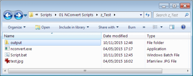

In a quick test I just set up, an output folder that didn't exist was created when the script ran, so possibly you need to back up a bit...kewbsl wrote:I'm writing a batch process to merge groups of tiffs into one pdf and I've got it working so that it can create the file, and everything looks great. One last thing I'm trying to achieve and I can't seem to find it: there are hundreds of thousands of files in random folders and I want to store them in a new folder structure. So instead of them all being in c:\nconvert\ they should be in subfolders like:

I ran this code:

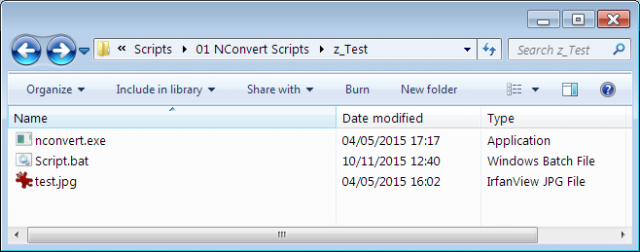

nconvert -out tiff -o output\test.tiff test.jpgI should explain that I normally run scripts as batch files .bat in a folder containing a copy of NConvert, as when I first started using the command line I found that was a simple way of ensuring the scripts ran...
